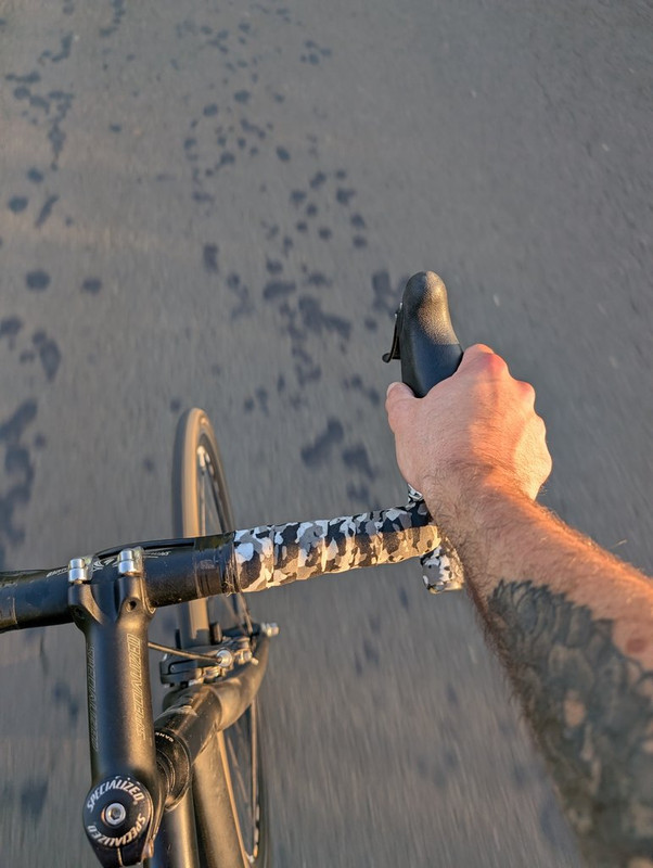

I noticed last night that this seems to be how I'm naturally gripping the bars most of the time (probably as a result of a too-long reach) which might not be helping, looks a bit awkward!

Posts: 25815
Posted by: 13thfloormonk
That said, I've gradually been rotating my hoods inwards, aero style, rather than having them parallel and straight forward
I have a sore right wrist and doing this definitely helps.  I've only rotated the one hand though, to make sure the bike has best comedy potential
... but yeah, holding the bars there does suggest too stretched out
Posted : 19/06/2025 7:52 am
Posts: 26725
I'd be thinking shorter stem and get hands on hoods further forward from that pic. You wrists and arms are all inline and not relaxed.
Posted : 19/06/2025 7:58 am
Posts: 219
Yeah, that looks uncomfortable - your forearm/elbow looks like they could be pretty straight, and you're putting weight on a quite rigid spot - the top-to-shifter transition, or the shifter body (which is hard). It's totally a place I'll put my hand from time to time, but naturally, the web of my thumb lands on that nice rubber bump on the hood. (Also makes covering the brakes easier).
90 stem is a cheap way to explore shortening the reach and won't impact the handling too much at all.
Posted : 19/06/2025 7:59 am

Shorter stem based on that picture. Don't rotate the bars to correct for reach. I like to slide the shifters up slightly for a nice flat platform to rest on, but I think you are over-reaching and that puts more strain on on the wrist.
If you want rotated inwards shifters for aeroz, you need some narrower bars. I have x-wing and they are very good and comfortable. But not cheap!
