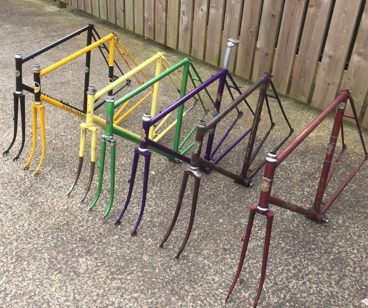

I'd go for steel forks if you want a 'retro' look - it's not just the tube diameter that changes with steel, often the whole shape of the fork is different because there's no offset in the crown.
(pic from a job lot of steel frames for sale on ebay at the mo).
