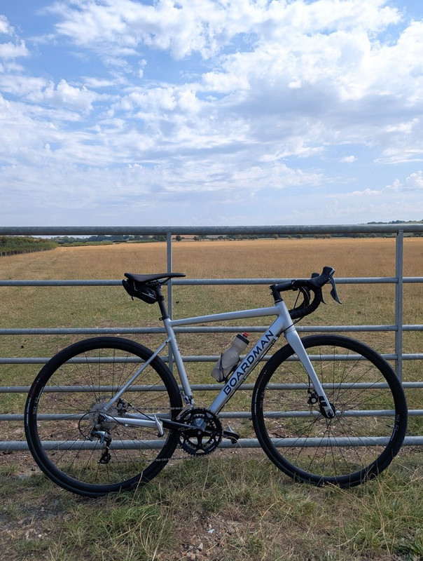

Here's a side shot of the bike, does anything look glaringly obviously wrong with bar/hood positioning etc?
Have you tried flipping the stem to raise the bars?
Posted : 16/08/2025 7:12 am
Posts: 9203
Not yet because a flipped stem is ugly, but feel like I might have to admit defeat and at least try it!

Posts: 2030
Posted by: _tom_
Not the prettiest road bike out there so I wouldn't worry! 😉

Just here to comment how amused I am by the armchair fitters suggesting changes based entirely on a pic of the bike. No pic of the OP, and certainly not of the OP on the bike or riding it.
I have no idea how good MyVeloFit is but would politely suggest it’s a whole lot better than someone commenting on a pic of the bike alone.

I pulled out a couple of pictures of our bikes (my bike fitted one and my two sons' bikes that we've had much more luck with setting up at home as I can watch them ride) and then looked at yours again.
This is just roughly based on that and the fact you have some fit issues that sound similar to some of mine and from what I remember from my fit and some common symptoms I had with yours.
Saddle
Looks to be pan flat.  Since my bike fit all of ours are nose down (just a little).  What I was told is it causes your hips to rotate into the right position for pedalling efficiency but it also helps your upper body lean into the correct reach as reaching forward doesn't strain the hip joints.
I'd say the amount of nose down is about one "notch" on one of those old school toothed seatposts.  In your picture my saddle nose would be overlapping that next metal railing in the gate.
I was dubious (for about 3 minutes) but again the natural action of your legs holds you in place not your arms.
Saddle might need to come up a bit to compensate.

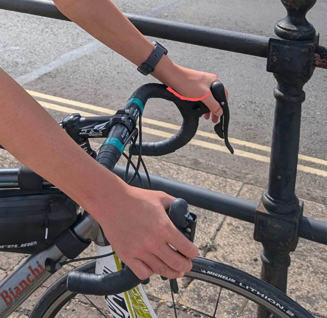

Bars
One other thing I am looking at is your bars.  The bottoms look like they are pointing down (at the back).  But also the section from the tops to the hoods slopes away towards the hoods before the main curve and your levers are pulled up really high and so tilted back, which I guess is to bring them closer.
That shape will give you a little V at the base of the brifters and an awkward kink at the wrist. That might be contributing to you favouring gripping at the base of the brifters as it doesn't aggravate the wrists.
I had a set of bars with similar geometry on my old Bianchi.  It created an awkward wrist angle in behind the levers.  They went in the bin very recently as my son (who has acquired it from me) immediately hated them/spotted the issue.  See pic.
The new bar is essentially flat from the corner of the tops until the main drop curve when the bottoms are also flat.  The brake levers are then up near the top of the curve.

One video from the guy I thought explained things pretty well.
It is a lot less clumsy trying to explain the bar point than I was above.
Looking again I think I did your bars a disservice as it's hard to see on the phone screen

As for getting bike fit advice from punters online based on a photo of your bike - that strikes me as a surefire way to drive yourself insane.

Just to say, my advice was not based on the bike picture, but the rider’s previous experience on another bike that didn’t fit (a bike I know and ride). People aren’t that variable and they tend to have similar issues; knee discomfort, too much weight on the hands and shoulders. Over-reaching is also common, and most of the cases I see are saddle position related in some way. And yes I have the badges (not that that really matters).
Yeah that was more just in case there was anything obviously wrong in the setup (ie bar roll, hood position etc) that would be preventing a comfortable fit. I've had a few road bikes (I had the CAAD8 for the longest) but with a MTB background I never really knew if any of them were set up properly haha

Posts: 8660
That stem is longer than 90mm, get a shorter one and probably one with some rise on it. Your hoods are also badly positioned (likely as you're compensating for the long reach, as I hope they weren't like that when new, but that amount of backwards angle will affect your wrist angle and might lead to shoulder pain.
For foot issues the main advice is to slam the cleats back as far as they'll go and get decent insoles (you can get knock-off G8's on AliExpress for £15).
Are you using the saddle that came with the bike or have you transferred a saddle to it that you know works for you? If not the latter then try that.
Posted : 20/08/2025 6:08 am
I've measured it at 95mm centre to centre, the spec sheet for the bike says 90mm. I have a 90mm Deda I can put on but probably won't feel much difference on that. The hoods were indeed positioned this way from new.
Went for a ride tonight and think I've got the saddle position ok now, I don't feel like I'm missing power from my legs now at least. Still getting the numb hands after about 30 mins though so will investigate bar/hood position some more.
