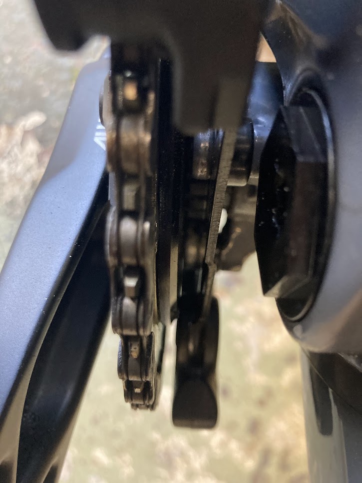

  IMG_3439.jpgIMG_3441.jpg Yes fitted one to my DH bike, its a weird feeling pedaling with it at first but you adapt quickly.
I had a bit of a faff making it fit with the chain guides, the picture shows how much it touched but I spaced it with a bit of fiddling, but that could be down to the DUb Wide bb?
Where are you based?

I'm in Sheffield.
I'm only running a top guide and a regular Shimano BB so hopefully clearance wouldn't be an issue.

Top Guide will be absolutely fine then, it was only the bottom guide that was snug.
For my Dissent it is a lot quieter and felt smoother it hasn't had many outings yet.
