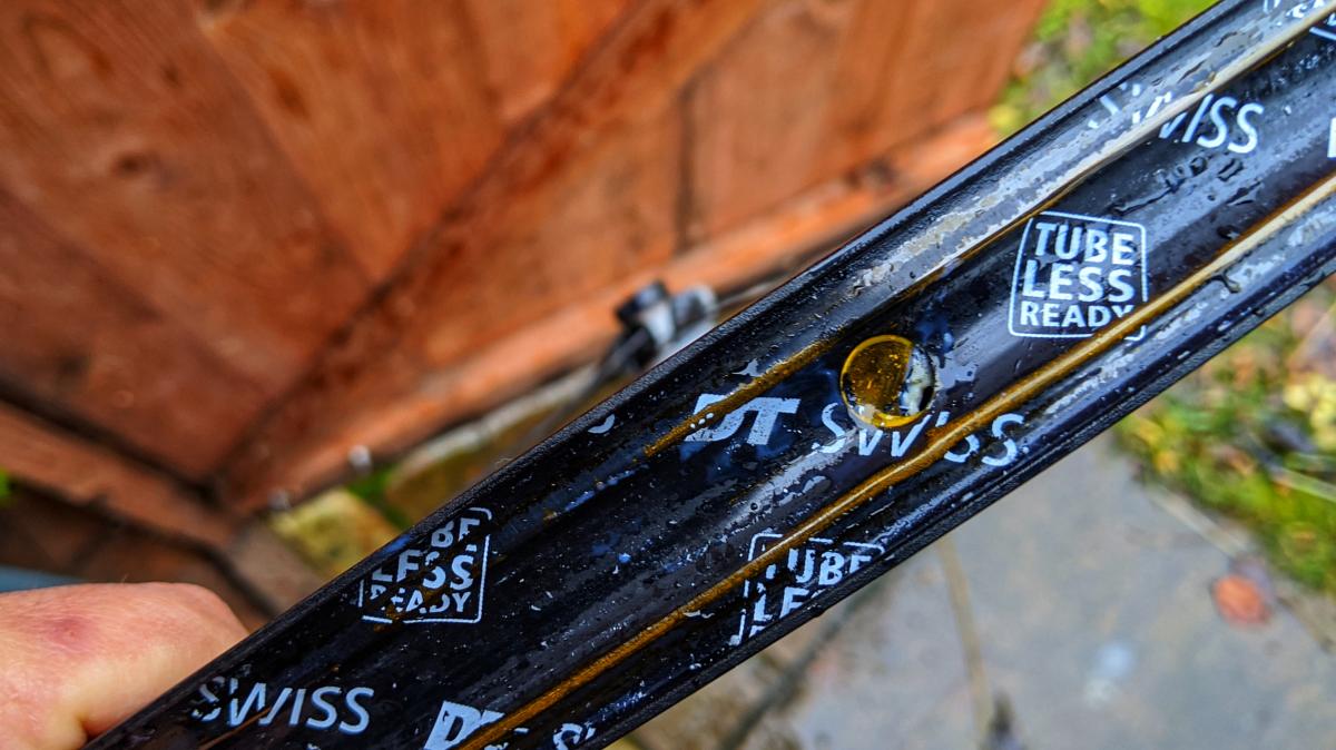

Oh for 🤬 sake! There was me thinking that switching from a fat bike to a gravel bike would mean that I didn't have to fix my rims or tyres after every 🤬 ride...
TL;DR I need some recommendations for tubeless rim tape for 24mm internal width gravel wheels.
So I picked up a pinch flat on the rear on Thursday, patched the tyre Friday morning, set it all up again and left it in the shed. Got the bike out this morning to cycle to work and pick up the car, noticed that the front tyre was flat.
Pumped it up to ~40psi and went inside to get my cycling shoes, as I though a quick jaunt up and down the High Street was in order, just to make sure Friday's patch was holding. By the time I came out, the front wheel was flat again.
So I popped it off the bead and pumped it up, this time I went to ~60psi, mainly in an effort to get some sealant showing, as there was no obvious signs of a puncture. There was a bang, then no amount of pumping would get it to hold any air. So off with the tyre, clean everything up and then I noticed that the rim tape had a hole in it.
Rim tape failure
I need to go and get my car, however, I don't have spare tubeless rim tape, or even non-tubless rim tape. I'm also out of fancy sealant too, although I have a load of the OKO stuff I used on the fat bike. I have an inner tube, and a load of electrical tape and a little gaffa tape.
Given how prone I am to punctures and what not, I'd rather not use the inner tube if I can possibly avoid it. Can I just tape over the hole (which tape?) and use the OKO Sealant, or will I need to use the inner tube...?

Is it normal for the rim tape to get worn away at the spoke bed like that? How old is it?

Tesa 4289 (the yellow stuff). You want the tape to be the full width of the rim bed. A good rule of thumb is to go with the external width of the rim. I'd guess if it's 24mm internal you probably want 27mm if you can find it, otherwise 25mm is probably OK.
The trick with tesa tape is to pull it *really* hard as you put it on.
Posted : 14/12/2019 4:17 pm
That rim tape isn't just worn at a spoke hole, it's worn along the length of the rim too. I'm struggling to see how that could happen.
Posted : 14/12/2019 4:22 pm
Posts: 3224
Stans tape calls for 2 wraps above 40psi I think. I haven't seen what DT say the pressure rating is on a single wrap but I'd suggest you just exceeded the pressure that the tape could handle.
The orange showing through is just the black print coming off. I've found some sealant types make this happen more aggressively. If you scrub the tape, more print will come off.

@alexnharvey a few weeks old. They tyres have been popped on and off the bead about five or six times since then.
@scotroutes Id quite like to know why it's so worn after only a few rides too...
@BearBack I was using Continental RevoSealant, as they tyres are Continental Terra Trail. It doesn't contain any ammonia or stuff like that, as the wheels came with all sorts of warning about using non-corrosive sealant.

I've no idea what's caused that, maybe it's been applied too tight and stretched too much?
I'd say that no tape I've ever used- stans, tesa, gorilla, specialized blue, cheap electric tape- has failed like that and I'd use any of them except for gorilla again, but then, maybe I've just not had whatever mad thing has happened here happen?

I have 4 wheels taped with that DT tape (mtb so lower pressure - no higher than 25psi) and one has gone the same funny colour and the black is coming off. Using stans standard sealant so nothing unusual.
No idea what’s causing it but just ignoring it for now as it’s holding air ok. Maybe I stretched that too much - previously I’ve taped with wtb tape and you really needed to stretch that on to get it smooth and in all the curves of the rim.
I’d imagine the hole is due to higher pressure - maybe it needs 2 wraps as above.

Looks like the tyre's been moving around hence why its taken the black off revealing the amber tape below. I'm not certain on that, but the rub on the tape certainly makes me think the problem isn't the tape itself.

I'd agree with movement friction rubbing the black print off. Either you rubbing old dried sealant off, the tyre bead at install/removal or an inner tube moving back and forth. It doesn't take much once it's been sat in sealant.
The print is superficial, it's not the actual rim strip being compromised.
I'd clean it, put an inch long patch over the holed nipple hole then a full second wrap of DT tape (or start/finish at that nipple hole to give you your overlap double and repair at the same time.

That DT Swiss tape looks over-stretched, mine didn't look like that after 2 years and tyres being taken on an off ever couple of month.
I have however see it go orange when I cleaned off old sealant with alcohol, the black colour and white print come off with that solvent at least. The tape was still airtight though.
I have also gone to DT tape on my non-DT wheels after using Tesa tape and finding it to be pretty crap in comparison - doesn't deal as well, not as flexible, leaves residue on removal and isn't nice on fingers when applying.
