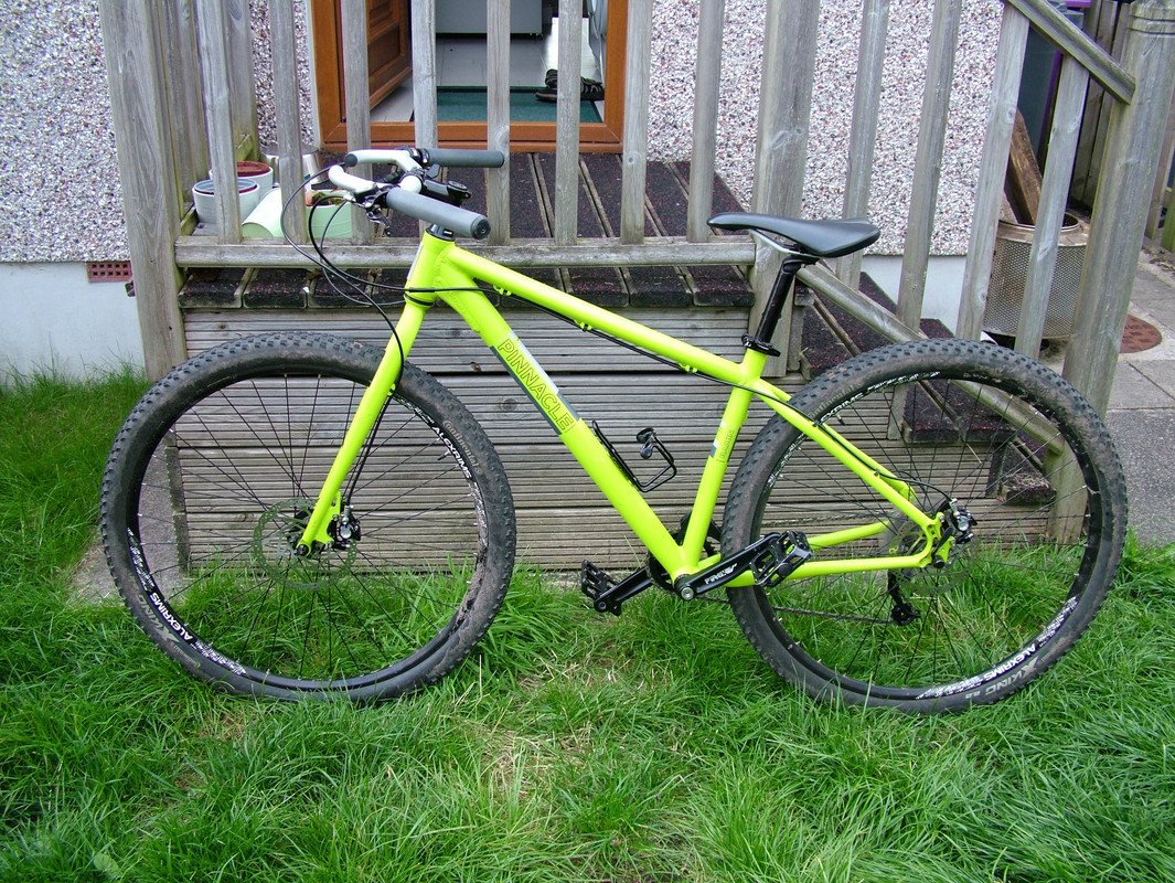

Love mine. It has gravel wheels,29 wheels and plus. All the bikes you'll ever need!

Tazzy, is that a Ti prototype of a Stooge Dirtbomb?

@Tazzy what are those bars in the ti Stooge? They look 🔥 ..

this stooge is a custom just for me called the motobastard (motorhead reference) with a very tweaked geometry. the bars are a special set of locked components media blasted by them to match the frame.
its a stonking little beastie as as much fun as the original ti speedball prototype it replaced for general riding and a total nutter on the downs

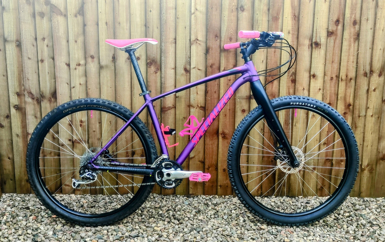

More of a test to see if I could add an image, but just finished building this up as my off-road touring/bikepacking rig.
Selcof carbon forks with the pack mounts, think they're about 510mm a to c.
Front tyre is 2.6, rear 2.1 but could fit a 2.3 when/if I go 1x at some point. Has rack mounts on frame, which is something I've been after that a lot of modern hardtails don't have.

Posts: 1421
Rockhopper expert 2018 frame, pic shows with Geoff bars with 35° stem, but since swapped to 50mm stem with some 76mm riser bars.
Edit... Cheers Damascus. Photo link works a treat 👍

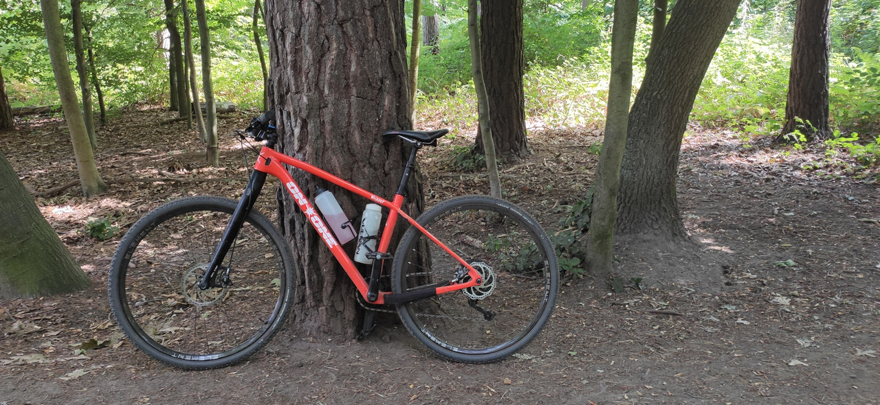

Hi,
Just thought I'd update this thread.
After looking for a rigid bikepacking bike that wasn't steel I gave up and bought one of these instead and fitted it to my scandal.
https://www.tritoncycles.co.uk/frames-forks-c6/rigid-forks-c51/trek-1120-adventure-touring-fork-p20815/s99845?utm_medium=ppc&utm_term=trek-1120-adventure-touring-fork-colours-nautical-navy-colours-nautical-navy-5257709&utm_campaign=froogle&cid=GBP&glCurrency=GBP&glCountry=GB
[url= https://i.postimg.cc/1tF0SNyR/20230811-151741.jp g" target="_blank">https://i.postimg.cc/1tF0SNyR/20230811-151741.jp g"/> [/img][/url]
[url= https://i.postimg.cc/RZvgTG47/20230811-151748.jp g" target="_blank">https://i.postimg.cc/RZvgTG47/20230811-151748.jp g"/> [/img][/url]
Combined with an old man mountain rack and Robert axle project axle it can now fit a rear pannier rack.
Really impressed with the fork. It weighs 844g. The front rack that fits the fork is 447g.
I fitted a new hope headset and crown race. This fork has a metal steerer so fitted a star nut so I'm hoping no more headset wobble after a hard ride that I got on the genesis tarn fork with the fork bung.
Photo taken outside my local bike shop before putting in my van. Apologies for not aligning the cranks and wheels.

Posts: 3783
Looks good 👍
Thanks @superstu. It actually looks exactly like it did before with the genesis tarn forks but it has the extra mounting points.
Its a lot of money for 6 bolts on the side of the forks and 4 on the top for the rack 🤣
