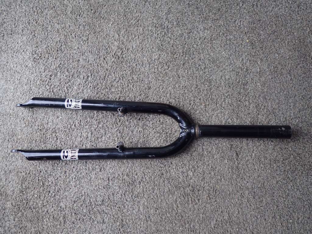

Sorry should have read your post better. I have some project two forks which were fitted to a Marin Pine mountain.
I will measure the steerer and the ac tomorrow. If they are suitable you are welcome to them for free, if they are suitable.
Will measure and photograph tomorrow if you are interested.

Posts: 257
Hi Bruce
Yeah I’d be interested that would be great. Let me know.
thanks
Tom

Posts: 1844
The project two forks are about 210mm top of dropout to top of crown race seat. Or About 215mm centre to top of crown race seat.
There is about 195 mm of steerer.
P1090045
