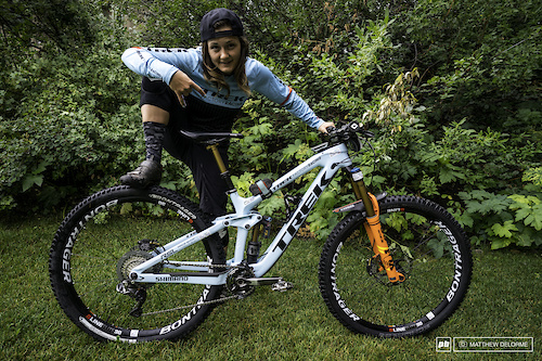

Posts: 1748
Katy Winton is 5'2" and rides a 29er Trek Slash. She does alright on it too 😉
https://ep1.pinkbike.org/p3pb15043073/p3pb15043073.jpg
