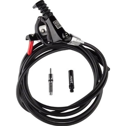

This photo shows all the bits that came with the reverb we fitted yesterday. I know what the "enduro collar" is, we used the syringes and fluid after some minor mishaps with trimming down the hose, and the "matchmaker / MMX" clamp was surplus to requirements as there's no SRAM / Avid brakes in the family. And I'm not so daft as to not know what cable ties are for. However, I'm curious what all of the other little bits are for.
In particular:-
- red plastic nipple thing?
- screw / bolt with a hex end? (Not the disposable hex key, I know about that!)
- black rounded piece (in between the RS logo on the leaflet and the RS logo on the syringe in the picture)
Any clues? Manual didn't seem to help much...

The curved black bit fits in the clamp for mmx shifters in place of the brake, works fine without it though. I read somewhere what the red thing was for (probably here) but it escapes me right now

1.Covers the end of the hose if you are feeding it through the frame
2.If its the double ended threaded thing is used to attach a bit of gear cable to help threading through longer bits of bike
3.Goes in the clamp if you aren't combining it with a brake lever.

3 ^ as above. Works if not clamped to anything else. If you've got compatible SRAM/Avid brakes though the Reverb joins to the end of the brake lever that looks like the curved black thing, and makes for a very neat fit and tidy bars 🙂
Not sure about screw/bolt with hex end. The black double ended clamps though are awesome. Allows you to clamp two cables together to stop them chattering or rubbing but allows the cables to move. Better than just cable ties.
The other black piece should be the cable guide. Cable ties are used to wrap it to the Reverb and the hose goes in the guide. Prevents too much ballooning when lowering.

The screw might be this, for attaching MMX shifters, and the red bit is just with it for when used like this to stop the screw falling out. Bit like Ikea packs, they send you everything inc the cable guide even though it's a stealth...

Bolt with end...you mean the allen ket type thing with the torx end? If so, that does the bolts up on the clamp to the bar and I think also used for the bleed nipples.
