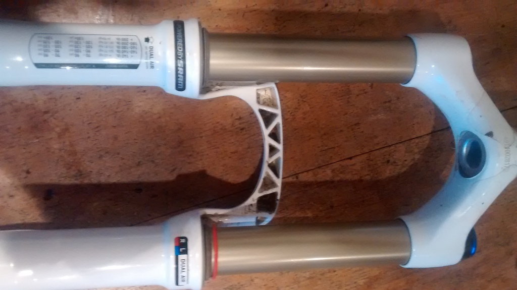

Does anyone know if all 150mm revs can be reduced to 130mm? They're straight steerer of it helps, cheers

Solo or dual air?

These ones

Lowers off,air shaft out,clip on a 20mm spacer.Job jobbed.
[url= http://www.bikeradar.com/gear/article/workshop-how-to-adjust-travel-on-a-rockshox-trail-fork-26840/ ]here[/url]
(or over inflate -ve chamber till required travel is reached....makes em a bit divey though)

Would anyone happen to have the proper spacers or link to where I can get them? thanks

Emither me your address and I'll stick one in a henvelope.
