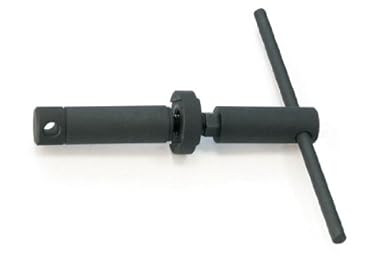

The drive side isn't capped as such, but has a 'fixed' cup - there should be a flat on either side to remove it. They weren't called fixed cups for nothing, and their removal from an old frame requires the strength of a gorilla and the patience of a saint. Bike shops used to use a fixed cup removal tool that clamps onto the cup so it can be turned (left hand thread)
