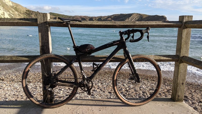

Ibis Granny
Bought a second hand Ibis Tranny in one size too small (to solve the long top tube / short stem issue) to make into a gravel bike / travel bike (because the frame comes apart).
Comments from that build:
You'll typically be able to fit a 650bx47 in the rear of an old XC frame; I went with 42mm Resolutes with enough clearance.
Mess around with your current sus fork if you can shorten the travel somehow (easy on my air forks) once you've fitted drop bars to work out how long a rigid fork you want (went with 440 on this build).
Hylix are slightly (!) more reputable cheap carbon forks.
Couldn't be a***d with hydraulics as I wanted to reuse old road shifters that I already had, cable discs work well enough if you're only riding fireroad. I'd try the V-brakes and current wheels before spending more on discs. Of course disc mounts bail you out of wheel size rim brake issues.
I run the rear mech with the clutch off without issue but dropped the chain off an XT 40T ring before I got a custom NW one, so clutch mech maybe but NW ring definitely. Or front mech?
