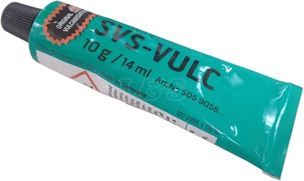

@jimmy748 and @Tracey - those mushroom patches, are they just standard motor bike ones? are they self adhesive or do you need glue or any special tools to use them? any particular brand to look out for or just whatever relevant size on amazon?

Glue them on, various sizes on Ebay, our most used size is 3mm. Got a big tin of vulcanising glue rather than mess about with the little tubes. Once the metal end is inserted I pull through with a pair of pliers to ensure a good seal

I think mine were advertised as 4mm, and I use TipTop SC-BL cement (the blue really strong stuff)

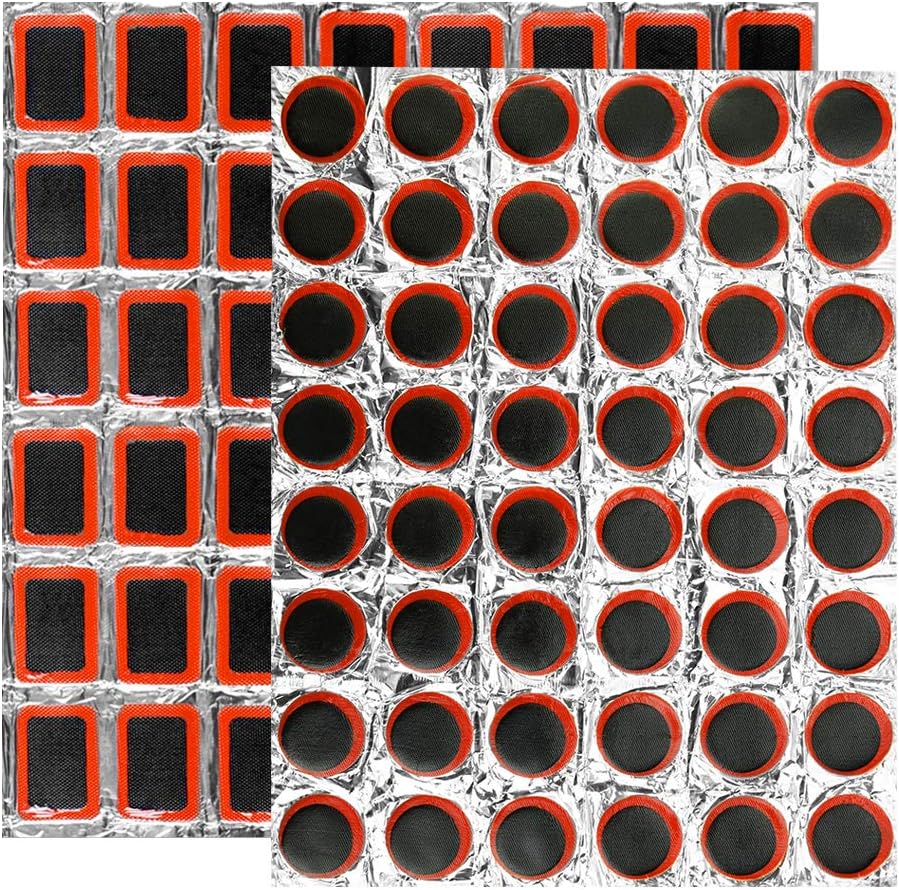

Ordinary patches you'll struggle with the orange band all the way round that could interfere with tyre seating, unsticking and being too close to the cut itself
Weldtite do 'edgeless' patch strips that you cut to whatever size. More flexible and seem to stick better than most patches. Only need a couple of inches square if that. Have run them for ages with no problems across various tyres

If there's space for a mushroom, then I use a mushroom. But if it's right at the bead then a standard vulcanised patch. Not a self-adhesive one, a proper one.
