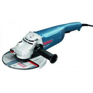

I asked a similar question the other day. I ended up getting mine angle ground off.
Took all of 10 seconds.

I've usually wanted to save the crank & replace the BB in which case an angle grinder with one of the 1mm fine stainless cutting discs is through the axle in seconds & the taper has then always knocked out easily. If for some reason you wish to save the BB it's just a more tedious job to saw the crank arm.
