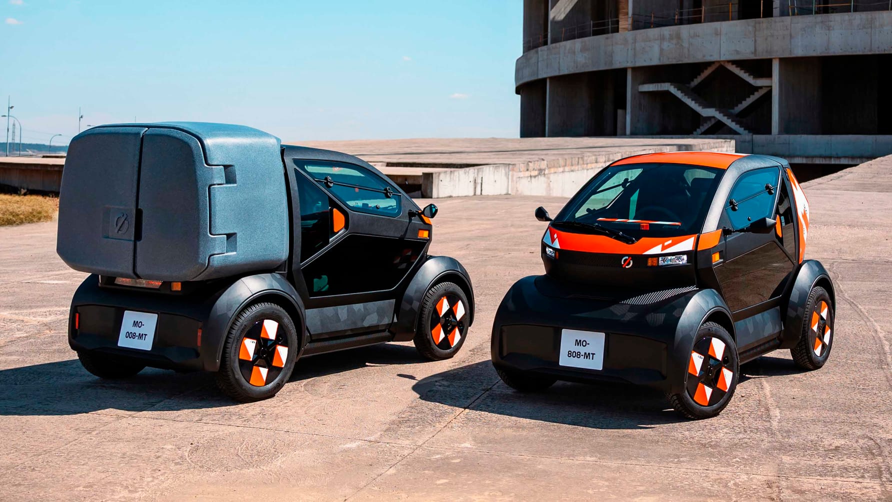

Posts: 3438
Or a twizzy 😀

Not a chance, not a chance, not a chance!
Intrigued by a super-tiny leccy car though...
Always assumed they would be pointless anywhere hilly... but looks like I might be wrong...
Posted : 13/08/2025 12:20 pm
Posts: 8722
Citroen Ami
