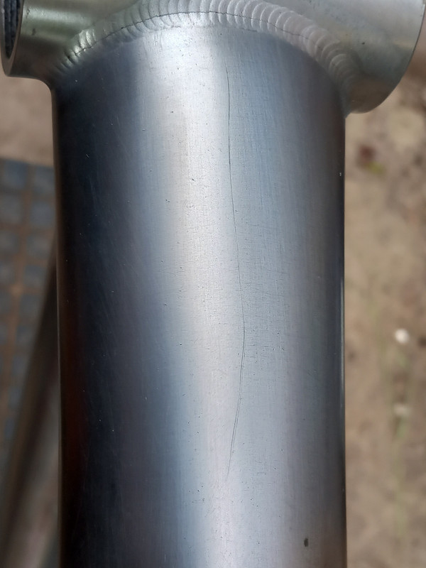

The inevitable has happened to my Lynskey after 11 years.
null
It's got a lifetime warranty, but most manufacturers consider 10 years to be a lifetime don't they?
It would probably cost more for return postage to the USA than a local repair anyway.
Is there anyone near Worcestershire who can repair it? I'd prefer to take it in person than post it.
I'm only 25 miles from Birmingham 'The Workshop of the World' so I'm sure I could find a titanium welder who could weld up the crack and add a gusset, but I'd also prefer to deal with a proper frame builder who can weld it in a frame jig to check alignment.

I reckon it might need an entirely new chainstay, could be very pricey.

I reckon you’ve done well with 11 years out of a ti frame - and with no proof of purchase you’re probably up against it with warranty.
Also, you could spend a lot of money on a repair and then a frame of that age could fail somewhere else.

From my experience with a similar failure on my Blacksheep frame you'll need the  complete stay replaced or even better both stays . Mark at Enigma did the first repair on mine - really good job with great looking welds,  then the chian stay snapped and he wouldn't repair it only replace - the cost and time to get one from Blacksheep was ridiculous .

I think it may be new frame time.
I'm not 100% certain, but that looks like a crack, not a scratch, running up the downtube. The weld is definitely cracked.

Errmmm - that looks fubar to me.
No legal recourse after that time unless you want to try breach of contract over the lifetime guarantee especially given your history 🙂

That crack in the weld by the BB!!!
New frame time…
Time to test what “lifetime” means on the warranty I’d suggest.
