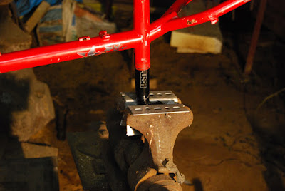

Do you mean when you have decided the seatpost is a goner?
Stihlsons trump something you have to squeeze together for grip.
I've never freed a seatpost by grabbing it with anything though. Old saddle in the clamp in the first non nuclear option. The clamping the clamp in a vice with a dirty great bench underneath.
Posted : 26/08/2020 11:22 am
As Josh says,post in well secured vice and (carefully)use frame as the lever.
If this does not work look at other options.
What materials are the post and frame ?
Posted : 26/08/2020 11:33 am
It’s a steel frame and I think also a steel post (1990 Raleigh ATB). The saddle was attached to a short, smaller-diameter post inserted inside the main post (WTF?) so no use for using for leverage. I’ve managed to get the post to move by blasting it with penetrating oil and hitting it with a hammer, just need to get it all the way out now.

If the saddle is still attached then I've found that using a pneumatic chipper/hammer works well - block of wood to the underside of the saddle, then apply chipper/hammer to the wooden block - the high frequency blows will gradually ease out all-but-the-most-stuck of seatposts. Alternative to the pneumatic tool would be a hammer drill (grip a bolt into the drill chuck, rather than a drill bit).
Posted : 26/08/2020 2:17 pm
In that case drill a hole through the post stick your largest long strong thin thing through it sit on the ground feet against the seatstays and top tube and start twisting and pulling.

Try soaking in PlusGas, for a good few hours at least, and I mean drench it.
Then, get a stilson, and a length of pipe which will fit over the stillson handle. Thick wall tubing like steam pipe or scaffold tube is best. Now secure the frame as tight as you can.
Slip pipe over stillson handle and apply even ,measured pressure until the teeth of the jaws startvto bite. If you've never used a stilson before, its critical you get the orientation of the jaws correct. Checking they bite is crucial, if they dont feel solid, rotate the wrench 180 degrees ie flip it over. Reapply pressure, evenly and gradually. Do not snatch at the stilson.
Leverage is king here, work smarter not harder. If its still no go, increase the length of lever you are using on the handle. Onceyou get movement, drench in PlusGas again and repeat. Try to use as short a lever as you can get away with to prevent the chance of the post shearing off in the frame.
I fix press tooling for a living, 10 tons plus, and we can move these with a 5' bar using leverage.
Good luck.
