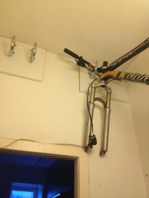

cantilever Wall solution - only 8 screws, 4 in the timber 2 inch but good threads to spread load/catch the joist at the top and 4 in the hooks. Inch long.
