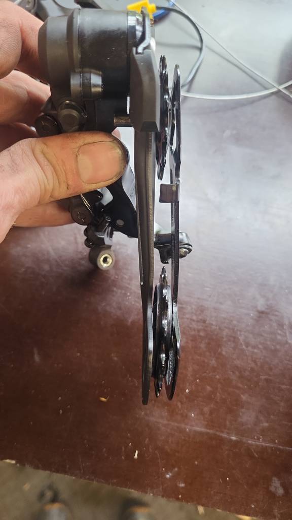

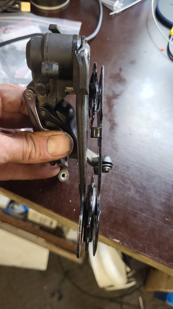

Posts: 2923
Old
Posted : 30/06/2023 2:55 pm
Posts: 2923
There is the issue ☝️
Posted : 30/06/2023 2:56 pm

Posts: 2923
New one ☝️👍

Posts: 10225
What’s the issue - bent / twisted cage? I think as standard there is a bend to the cage so it’s hard to tell what’s right and what’s broken.
That top jockey wheel does look a funny angle though.
edit - just seen the extra photo - old cage wasn’t looking too good vs new one.
