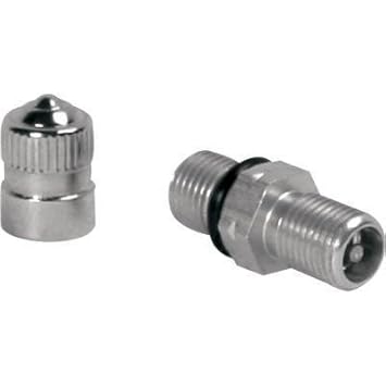

Also, on fox shocks the actual valve assembly is simply screwed into the body and is a replaceable part, this is obvious on the older types as it's nutted, but the newer ones screw in as well. There is an o-ring on the valve body (not core) where is seats into the shock body, this can also perish so might be worth checking that seal too, and again, check the valve is nipped up tight.
example older type:
example newer types:
you can see they both have o-ring where they fit.
It might be something more sinister but best to cover off the easy options first!
