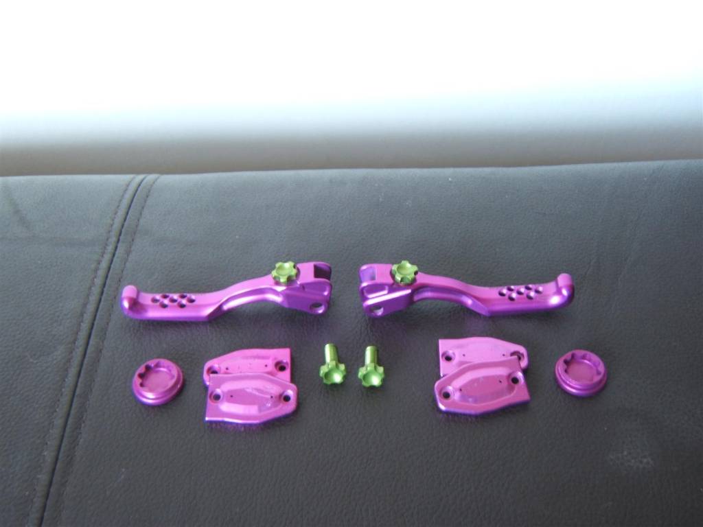

A member on Retrobike did some parts for me. He was saying one of the hardest things is you have to spend a long time preparing the surface, then get that surface perfectly decontaminated.
The parts need to be free of defects, as anything will show up on the finished part and get highlighted so wont look so good. New parts were preferable, but again after stripping, the stripping solution gets into the pores of the metal and needs extremely well cleaned to get rid of it all or that affects the finish to.
He did some of the first Hope tech levers in purple as they didnt come at that time in purple(Haters look away) So to fit in with my narcissistic attention seeking leanings, I was the only person at that time had hope tech levers, bore caps and master cylinder covers in purple.
Then those sob's at Hope released the tech evo in purple 👿
You can actually see a bit of a score on the bottom left master cylinder cover. That wasnt evident to the same degree when i sent them off, but the re-anodizing really highlighted it.
They are also a different alloy grade/type to the levers and bore caps, so the colour was a bit hit/miss and didnt turn out so well.
