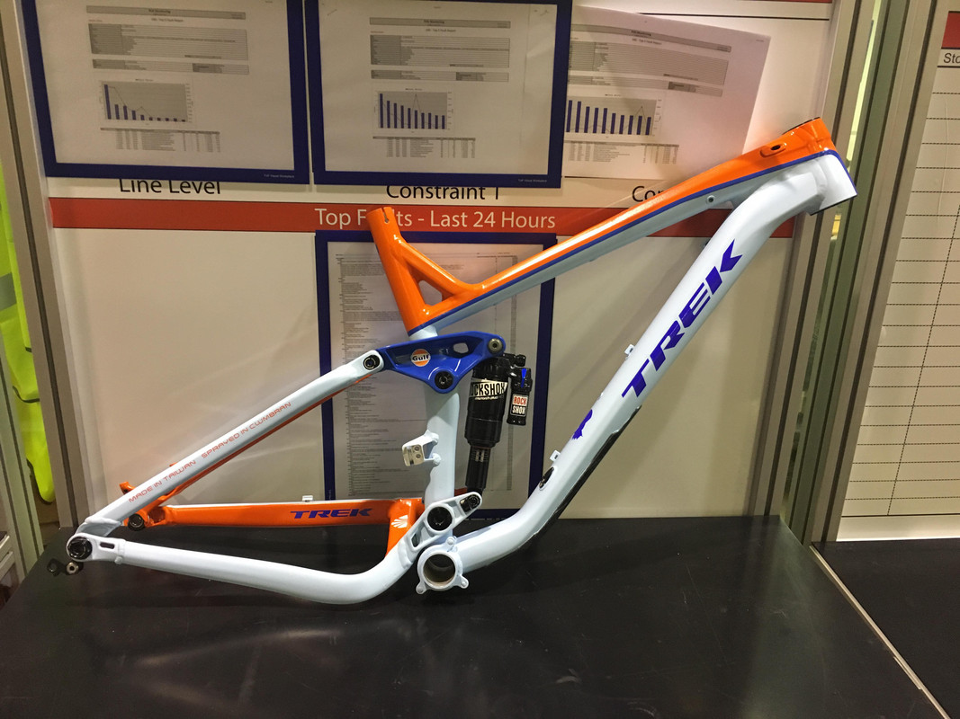

Another big thumbs up for Spray.bike. Its so good. I will post up pics of my finished bike soon, just waiting for the last decals to arrive.
But here's the frame... In Gulf Racing colours
Posted : 03/10/2018 9:03 am
 Bez
Posts: 7371
Will be interested to hear how durable it turns out to be and how painstaking your spraying process was… I'm guessing very 😉
Posted : 03/10/2018 9:09 am
Yeah, thats a good point - durability has a question mark, but hopefully it wont be too bad.
The actual paint process was easy enough, its the masking that was difficult for me, especially on a full susser with all the bearing ports. Sanding an initial key was timeconsuming too on the complex parts (rocker link, stays etc)
I'm so anal about stuff though that it had to be as perfect as I could get it. Luckily I have patience when doing stuff like this.
