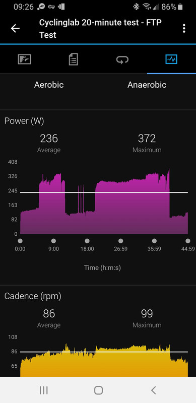

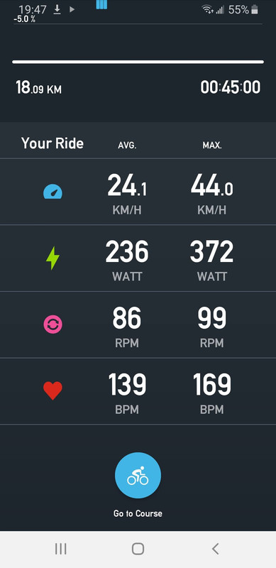

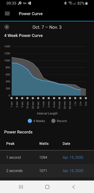

Soooo, OP here...
The ramp test I did suggested an FTP of 318w (which I thought was overly optimistic) but I've just done a dedicated FTP test using the Tacx Training app. Unfortunately, unlike Zwift, the app doesn't tell you what it's calculated the FTP as...
These are the results:

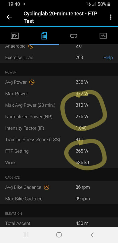

Looking at the same activity once it's loaded into Garmin Connect:
Garmin seems to think my average 20 minute power is 310w so does that mean my FTP is 310w or 95% of 310w (294w)? Or something else???
(I think the FTP setting of 265w shown on the second screenshot is just from an old ride I did a few months ago where I had > 20 minutes of solid climbing)
Posted : 03/11/2022 6:40 am
Posts: 4195
For a 20 minute test it is normal to take 95% of the 20 minute average power which would put you at about 295w (0.95*310). I think the FTP setting is what it is set to within your Garmin Connect app.
Posted : 03/11/2022 6:47 am

What’s your power curve in Garmin show? I’m going to guess you’ve got pretty high short power up to a few minutes which (I think) helps with the ramp test.
I guess eating all the left over Halloween chocolate gave me an energy boost but my plan to go out @280w seemed quite easy but I did get a new max heart rate 😁
Posted : 03/11/2022 4:30 pm
Posts: 5661
It'll be under performance stats, looks like this
[url= https://i.postimg.cc/FRmL6yc7/Screenshot-20221103-163131.pn g" target="_blank">https://i.postimg.cc/FRmL6yc7/Screenshot-20221103-163131.pn g"/> [/img][/url]
Would be interesting for us all to try it. I don’t think I’d do as well as I’d like
Group ride up Ven Top with keep together turned on, then? 🤣😬

Posts: 5661
Yep, that's what I thought I'd see haha, a peak power for 5 seconds well over 1000w.
