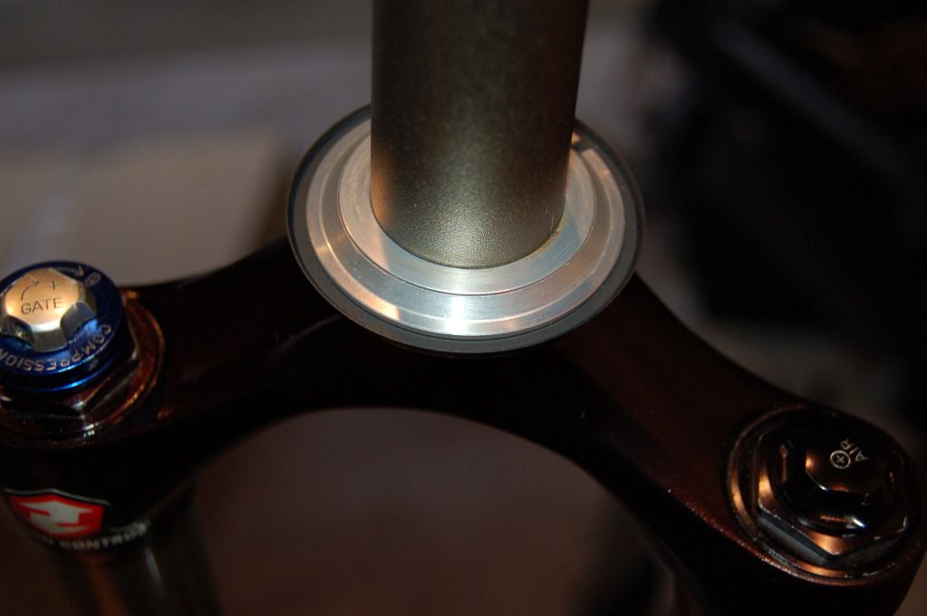

Adapter on 1 1/8th steerer and split crown race fitted
