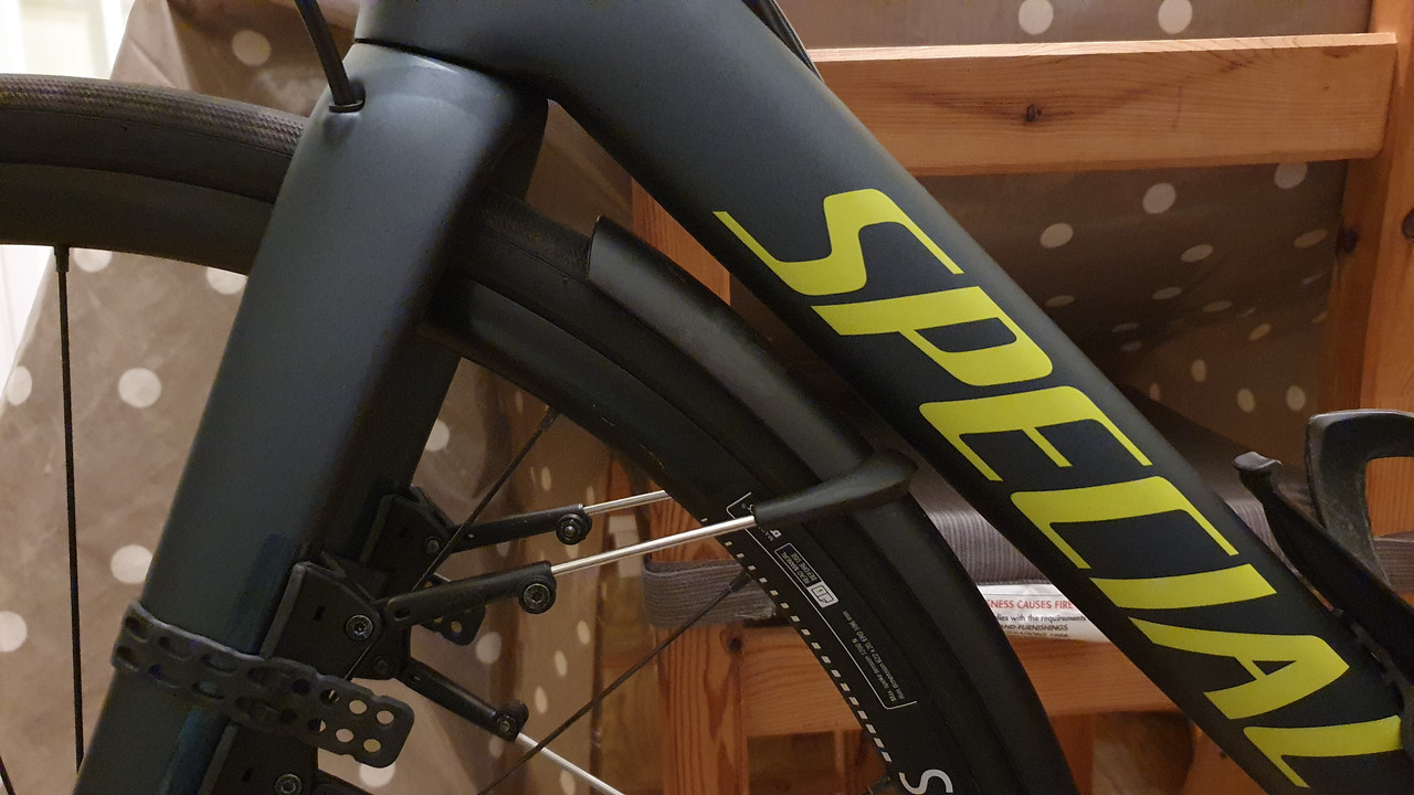

Dies anyone have any experience of fitting SKS race blades to a Specialized Tarmac or similar bike with limited front clearance? I've got the back one on no problems but there is so little clearance between the tyre and downtube at the front that I can't fit it without it either clashing. This is what it currently looks like (it's sat on the tyre at this point)
Are there any other clip in guards that don't require as much space?

Company called qbicle, sigma do them, that fits on the qr. Might be slightly more slimline than the race blade.

You could buy yourself a few mm by grinding off some plastic covering the metal bars where it goes over the mud guard, but basically that frame isn't designed to take mud guards.

I use crud road racers. I’ll probably get flamed here but I think they are better in every way. They stay in place, once the Velcro is attached they are easy to remove and install, they look better and have more clearance. And I’m also on a tarmac

Sl5 disc, and I have tubeless GP5000 25mm. The Velcro has been on for three years and I think it comes off with a hair dryer but I’ve never tried. Make sure you clean the surfaces very well with isopropyl or the Velcro will lift.

I leave the front off, it isn’t just the issue of fork/ tyre clearance, but also foot front tyre clearance. There may well be no clearance. So if not paying full attention serious risk of feet catching the mudguard.
