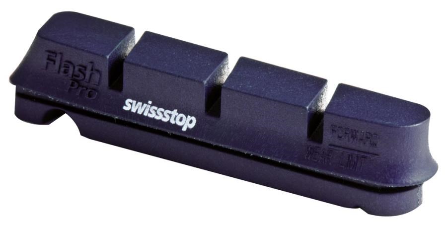

Actually, since we appear to have all the cantilever experts in one place, is there any accepted wisdom on long thin pads vs. short thick pads?
e.g. comparing the Swisstop BXPs to something like the Koolstop Salmons.
Just wondering if the longer pads require less toe-ing in...

Personally I wouldn’t go for the very long pads as they might be trickier to set up and are more likely to be a harder V brake compound.
Softest compound you can find in a block which isn’t massive I’d say.

I believe theoretically the size of the pad doesn't matter.
But in practice a longer pad may work better in the wet by clearing more of the water away, thus allowing the further part of the pad to do the braking on a drier surface than otherwise.

I was thinking more that the longer length of pad would prevent whatever mechanism it is that causes squeel if not toed in (I imagine the squeel is caused when the back of the pad gets pulled forward/under the front of the pad by the wheel's rotation which twists the brake arm and lifts the front of the pad off the rim? Longer pad length equals more pad 'behind' the brake arm so perhaps less likely to get pulled 'under').
It's not a big issue really, I just find it wasteful having to bin pads that still have lots of material left at the back but none at the front! Swisstop do a longer pad that looks like a precursor to the BXP compound, will try remember and order a set, see how they perform.
