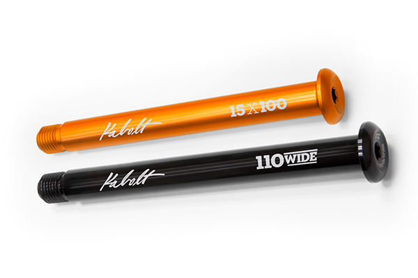

I guess you've just got the question of "why not bolt-through"? While it might not be needed, what downside makes it worth coming up with a new axle variation?
Posted : 15/02/2017 1:57 pm
Cheaper, simpler, lighter?
Posted : 15/02/2017 2:08 pm
Is it though? A one-piece machined axle vs at least 7 pieces for a QR. Is a QR hub not heavier than a bolt-through too?
Posted : 15/02/2017 2:11 pm
The hubs are the same just different end caps, then you've got to go out and buy an axle form shimano, syntace, fox, Rock-Shox etc (whic isn't one piece, it's probably more bits than a QR!). The dropouts need threads machining into them too, the Marin's dropouts on the other hand look like simple cut steel.
I'd have thought the hubs were practically identical, just change the end caps, then the bolt through axle would add weight.
Posted : 15/02/2017 2:25 pm
Ah yes - dropouts. You certainly need something for the axle to thread into but this can be a knurled nut with a retainer or a threaded mech hanger. complex.
I was thinking Maxle Stealth/Kabolt idea.
Ok - that's 3 pieces max.
Posted : 15/02/2017 2:34 pm
It's still a £35 part Vs a £5 one (at aftermarket prices, obviously they pay less), and you then end up with a rear wheel that needs a tool to remove, which won't be popular.
