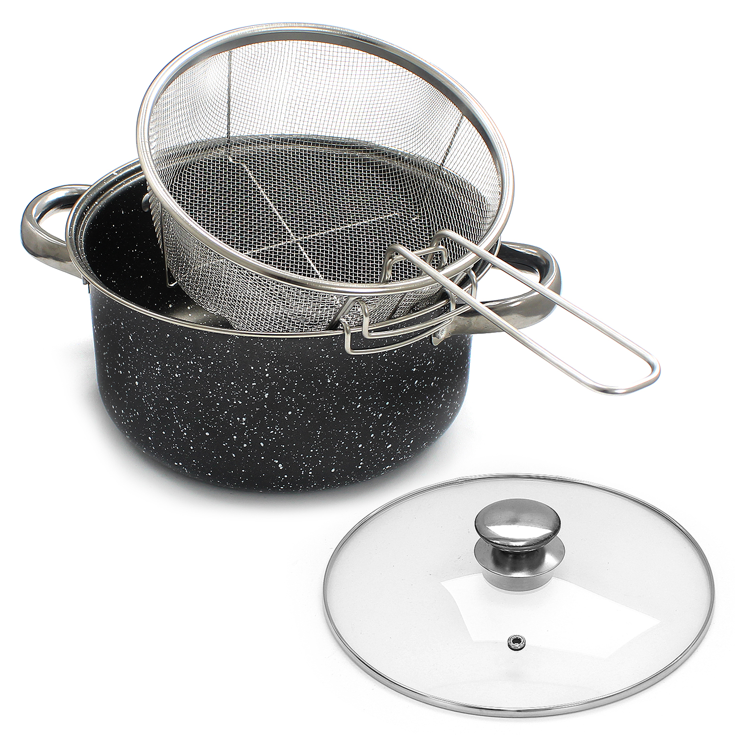

I've finally got around to buying some Putoline chain wax 🙂
What fryer is best for applying it?
Assuming it's better and easier to decant the wax into something with a mesh basket, so you can let the chain drip dry without handling it, and keep the wax in there for future use.
I don't like the idea of just heating the tin on the hob each time (and I suspect my wife wouldn't like it either!)
Something like this?
Or a plug in one like this?

I used to just use an old saucepan over a gas ring and hooked a bit of wire into one end of the chain before I put it in the wax.
Then I fished it out with the wire and hung it up over the saucepan to drip.

I thought of this, but liked the idea of having a basket - saves hanging up the chain, and potentially dripping everywhere.
Maybe I'm overthinking it!

The 15 quid one from Argos in your pic above. Super easy and saves you cooking up in the kitchen and stinking the place up
Edit: now only 13.99!
