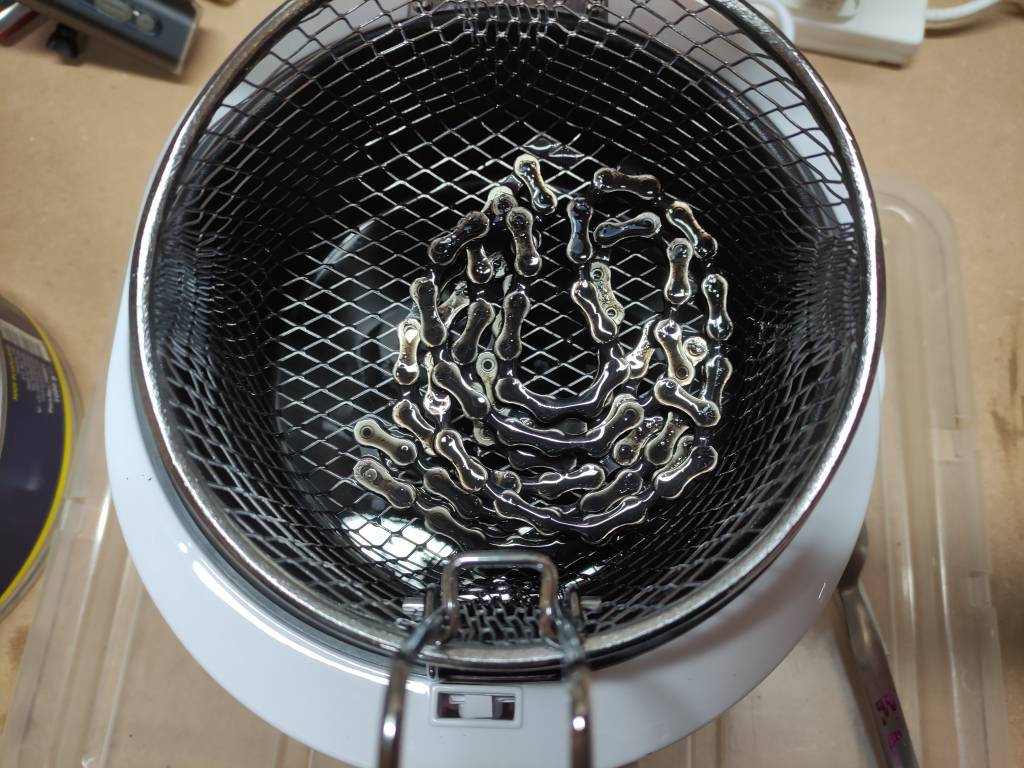

I've been applying in a DFF. I heat up to 180 then gradually let it cool before switching DFF off and letting a skin form on wax before removing chain. This way a minimum of wax runs off links but recently the amount of wax building up on chainring and jockey wheels has REALLY been upsetting my OCD, despite a wipe fown with kitchen towel once chain has cooled.

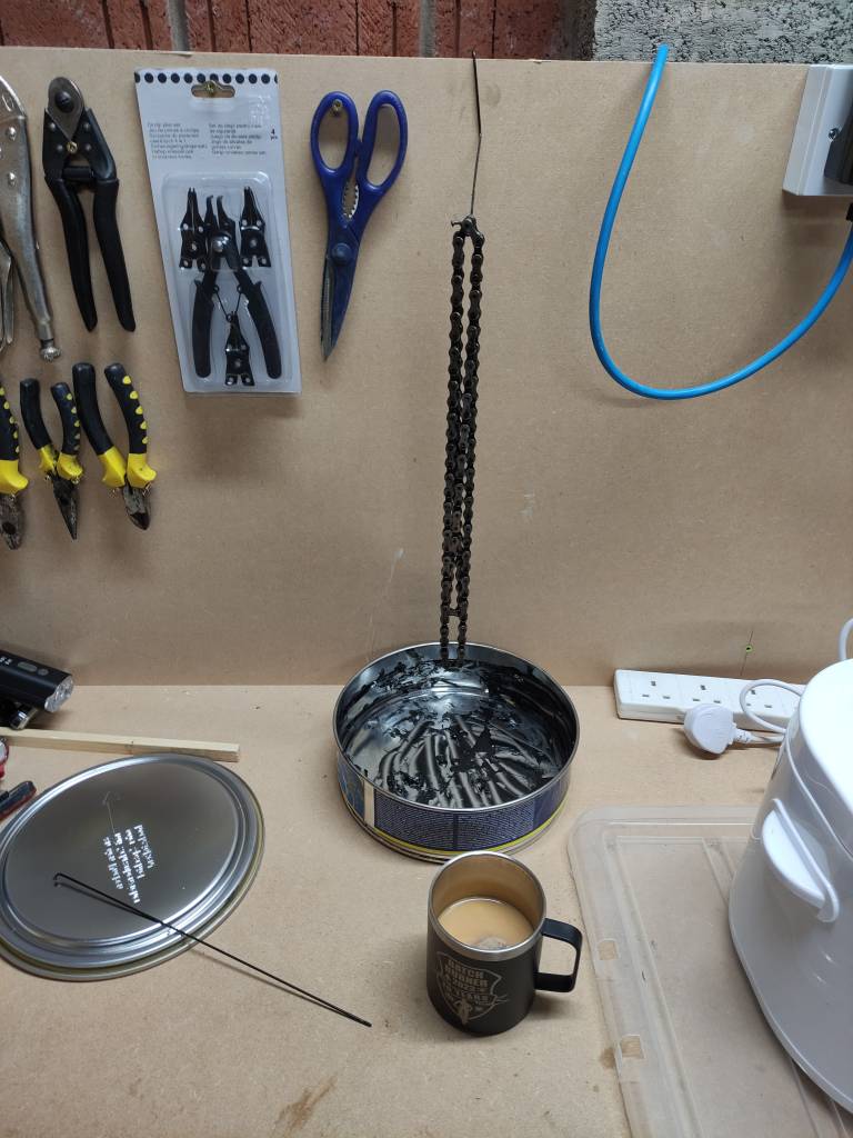

I wonder if you are leaving it in too long (????) also 180 is quite hot. I did my replacement chain today and I set the DFF to 110 and left it for 20 mins. I popped the chain in the basket and dunked it in for about 10 mins then I lifted the basket out, turned the chain over and left it for another 5 till there were no bubbles coming up any more. Then I hung it up and gently wiped from top to bottom just pinching the outer links in the rag, and left to cool.
When I put a freshly waxed chain on there is a bit of wax deposited on the jockey wheels/chainring during the first few rides but I wipe it off after about three rides and then it doesn't really get much worse. In fact it seems to get cleaner, someone even asked if I had just cleaned my drivetrain the other day - I hadn't...

My first application was done with just a burner under the tin and it worked well, lasted ages. I’ve since bought a fryer and it’s not lasting. Orange rust marks appearing after only a couple of weeks. Nothing like the original application. Will try some of the methods mentioned above

I reckon you are all heating it up too much and boiling off the more volatile contents hence the degradation in performance on subsequent applications.

Naaa, my original putoline is now 12 years old, I swapped to a new tin as I was convinced it had actually gone soft either due to thermal cracking or contamination with other lubes (I don't wash the chain either when new* or after using other lubes).
And for most of that 12 years I turned the fryer up till it smoked.
It's exactly the same. I guess 12 years ago I was boiling it on a trangia in the freezing cold garden of a shared house. Now I've gone middle aged and soft and do it in a garage.
*I actually think this is a bad idea as new chains always seem to stay greasy as the factory grease stops the wax getting in. But I'm lazy and just wax and and then ride till it's worn/washed away.

I twist the chain - you can tell from that when the goo is gone from the rollers. a well lubed chain its smooth and no obvious hard stop when you twist it - by the time it feels gritty and loose you need to redo it

Could only suggest you had maybe tsken chain out while still too hot? I turn frier off and try to take chain out just before a skin forms on wax, means chain will retain most wax between rollers.

So; (to cut to the chase) – has anyone tried a wax heater like this instead of the crock pot / fryer / putoline on the gas bbq mini hob options ?
Nope, but the fryer option comes with a basket, which is really handy for giving the chain a jiggle when it's in the wax, getting it out again and draining off the excess whilst it's still warm.
Posted : 14/03/2023 1:12 pm

Based on what TJ has said over several threads I just Putoline it, let it drain in the basket then hang on a nail to cool before refitting.
The chain has plenty of black wax on the outside which might attract muck, but I don’t care about that. It has plenty of wax in the rollers, which is demonstrated by my fatbike chain now lasting about 15-20 winter rides in the Surrey Hills finest grinding paste before sounding rough, instead of 1-2 rides using other lubes.
Posted : 14/03/2023 2:36 pm

You can feel it as you stir the chain around.
Another plus (if it matters) of the fryer and basket - you're not stirring/jiggling the chain around in the 'grit layer' at the bottom.
Posted : 14/03/2023 2:49 pm
The basket is important. You jiggle the chain around like chips and it helps the wax into the crevices and helps dislodge crud.
