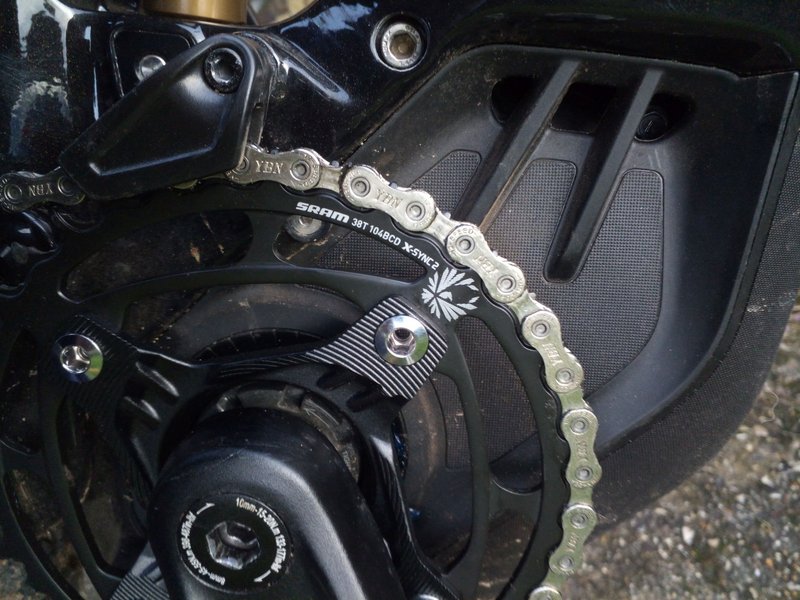

Nothing much new to add, but I Putolined a relatively fresh Planet X Jobsworth chain (rebranded YHA 11 speed, came out in the top 3 'most durable' chains in some test somebody linked in another thread).
Anyway, rode it twice with stock lube, complete with hosings-off afterwards, then Putolined.
Did my usual heat up to 160C, chain in, agitated etc, then cooled to 120C then turned the fryer off (don't know why I bothered with the 120C step, should just have turned fryer off).
I then promptly forgot all about it until about an hour later, went back to garage to find chain in a solidified lump of wax. So I remelted, repeated the usual steps, allowed to cool until a 'skin' was forming on the top of the wax.
Removed chain, just about too hot to handle through some folder kitchen roll so wiped off excess, allowed to cool and refitted.
Looks lovely and shiny but felt AMAZING as I was riding. I don't know how many watts you save with a well waxed chain, and I'm suitably embarassed to be claiming I can feel the difference, but this must be the third or fourth time I've waxed or re-waxed a chain and it's felt this good, so I must be noticing the Putoline.

Got all the gear (not quite no idea) and had the same issue on my road bike as pedlad. Ordered some 9 speed KMC quick links which arrived yesterday. Will also be chucking in a spare brand new 9 speed chain from my old Hardrock Pro I had lying around which will be useful - have a 2nd spare for some reason too.
Tin lid was a bit of a faff to remove but not too bad. Will give it a go by the weekend hopefully now my ebike is also back from the shop

Images on Instagram
Made a start, will see how it goes
Posted : 06/03/2021 1:54 pm

I treated my gravel bike chain yesterday. Fryer was set to 130. Inner chain had a lot more putoline left which is difficult to remove once it cools. Looks messy on the bike but worked fine. Chain nice and quiet even when riding through thick glup. Hosed it down when I got back and cassette still looks clean but definitely putoline on the teeth of cassette and front chain rings. As long as it all works I won't get upset over it 🙂
Just need to figure out how to leave enough on the chain next time but clean it up more.
