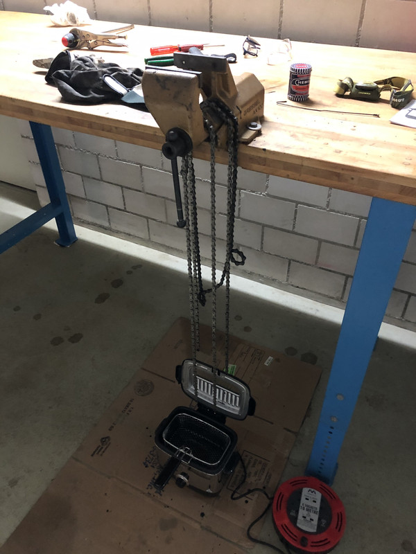

Chain is waxed and refitted to the bike. Assuming the post-ride cleaning process is as simple as some are stating I'd have no problem doing this after every ride, so if it lasts longer that's a bonus. Smells bloody awful when hot though.
Posted : 16/01/2020 2:10 pm

Starting reading this thread about "to clean or not to clean" I used to wax mine in slow cooker, was told no cleaning necessary. After a few goes, I tipped the chilled wax out of the cooker and there was a nice black layer on the bottom which I split off and put the cleaner top section back in for reuse. Dunno if that works with putoline.
Posted : 17/01/2020 12:24 pm
Posts: 4736
Is it supposed to boil when the chain is in?
Posted : 17/01/2020 4:27 pm
NO!
It should go nice and runny, you see convection currant in it and occasional bubbles
Posted : 17/01/2020 4:32 pm
Only if the chains got excess water on it. Then it goes crazy and covers your workbench in horrible boiling putoline foam.
A bit like you should never put wet chips in a fryer, or pour water on a burning chip pan.
Posted : 17/01/2020 4:35 pm
Also if it's still got solvent cleaner on it, it'll flash off very fast. Don't think it does any harm.
Posted : 17/01/2020 5:12 pm
Posts: 4736
🙁 I'll turn down the gas a bit. Chain was probably damp too.
Posted : 17/01/2020 5:53 pm

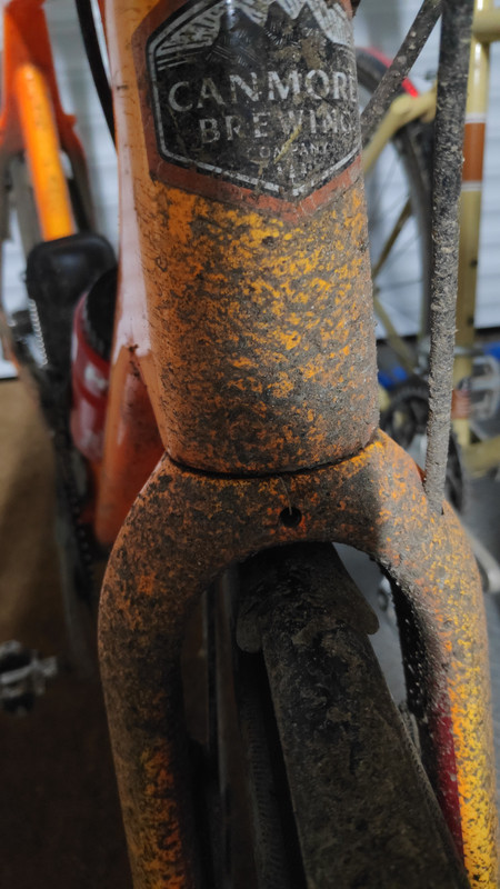

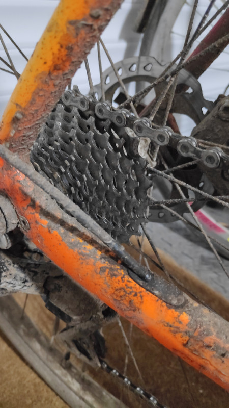

So my chain looked like this after 17 sticky, muddy FoD miles today;
I was hoping it would be cleaner.
Posted : 25/01/2020 11:11 pm

Doesn't look that much worse than some of the cassette cogs to be fair. More importantly, how did it hold up, still feeling smooth?
Posted : 25/01/2020 11:55 pm
Posts: 1613
Looks pretty clean to me after riding through 17 miles of shyte.
Posted : 26/01/2020 12:15 am

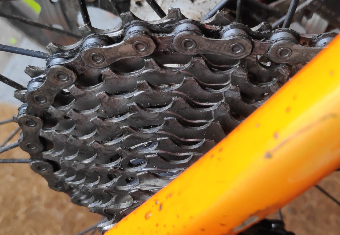

So how do you "clean your chain" if it's been putoline'd?
I see the pics from doomanic and adamT.
The putoline will be inside and on the chain doing its job.
But there is muck and grit on the surface, obviously sprayed off the tyres onto the chain you can't avoid that. Putoline rather than lube will mean less sticks to the chain.
But some does stick to the chain somewhat as in the pics - will it just gently wash off with a hose without removing the putoline?
Posted : 27/01/2020 9:23 am
I want to see what difference a decent coating on the outside makes on the next ride.
For me the outer bit flaked off and made the cassette and jockey wheels dirtier. But it might've made the whole thing longer lasting, I don't know, I didn't really evaluate it properly. I'd rather re-lube it slightly more often and wipe if it keeps things cleaner.

Posts: 779
It's working well for me. Pic below is 300km of dirty road/towpath riding after the one above. The cassette is still pretty clean, but the chain is a bit squeaky so needs doing again. I wiped the chain once in that time (about 120km ago).
null
Posted : 01/02/2020 8:28 pm
Posts: 779
Rest of the bike is filthy despite guards.

Posts: 3328
Interesting process doing putoline for the first time. Very wed and muddy ride this morning, but a quiet and smooth chain at the end. Hurrah!
When the tin arrived, even though I knew it was a litre, the images on amazon don’t really do the size of the tin justice. To quote The Big Yin ****ing huge!
The process itself was pretty easy, chain is HOT when you take it out and it can be very messy, but after chain three we had the technique down pat and it was remarkably easy.
Only other comment is: my goodness, its tenacious stuff in its waxy state - once its on stuff, it gets bloody everywhere (trousers, spoon, dishwasher 🤦‍♂️

@big_scot_nanny your garage is disturbingly clean, although the large screwdriver you've accessorised with Mole-grips is a nice touch.
