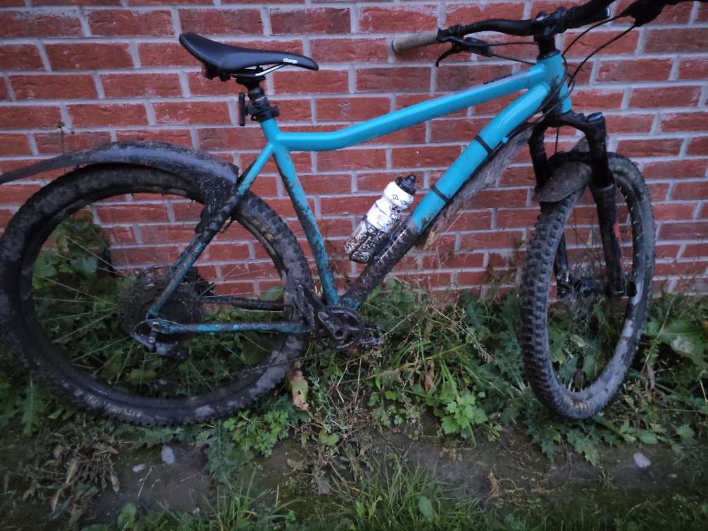

@fqzzini as a recent convert I ran my chain on factory lube (SRAM) until it started making noises. Then just dunked it straight in the Putoline fryer.
Gave it the first rewax over the weekend, as it had started to squeak. Not surprising when local riding ends up looking like this:
