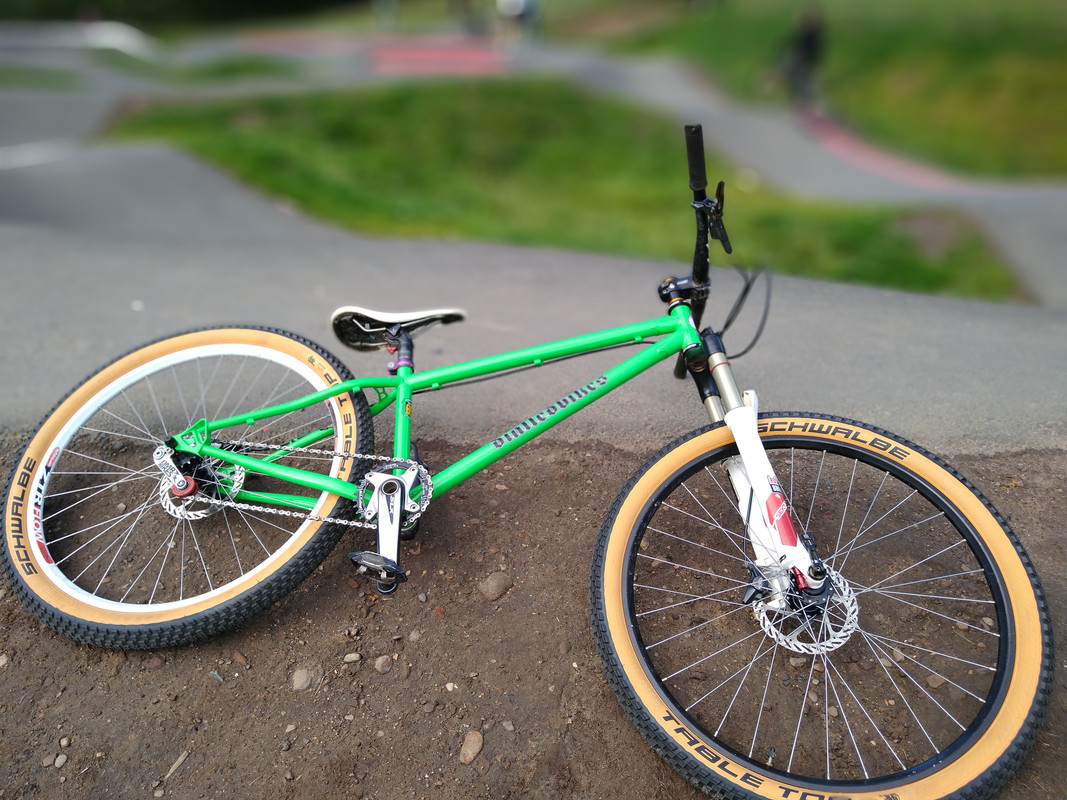

I built this up for the Chopwell pump track. It's fast and way better than I'll ever be on it.
Naturally, it's hardly been used.

And let's not skip over this!
Where is that, and what's that in the background? Looks like a right spot.
Posted : 22/12/2020 4:48 pm
Posts: 1713
Sharkattack - that’s the pump track in Fleet (Hampshire). They recently opened a couple of jump lines too (in the background). Been fun for a ground based middle aged under skilled rider like me to play on!
Posted : 22/12/2020 4:55 pm
Where is that, and what’s that in the background? Looks like a right spot.
also got a pic with Ben holding our Trailstar next to his that day... I'm probably in the back on the DJ because I'm lazy.
