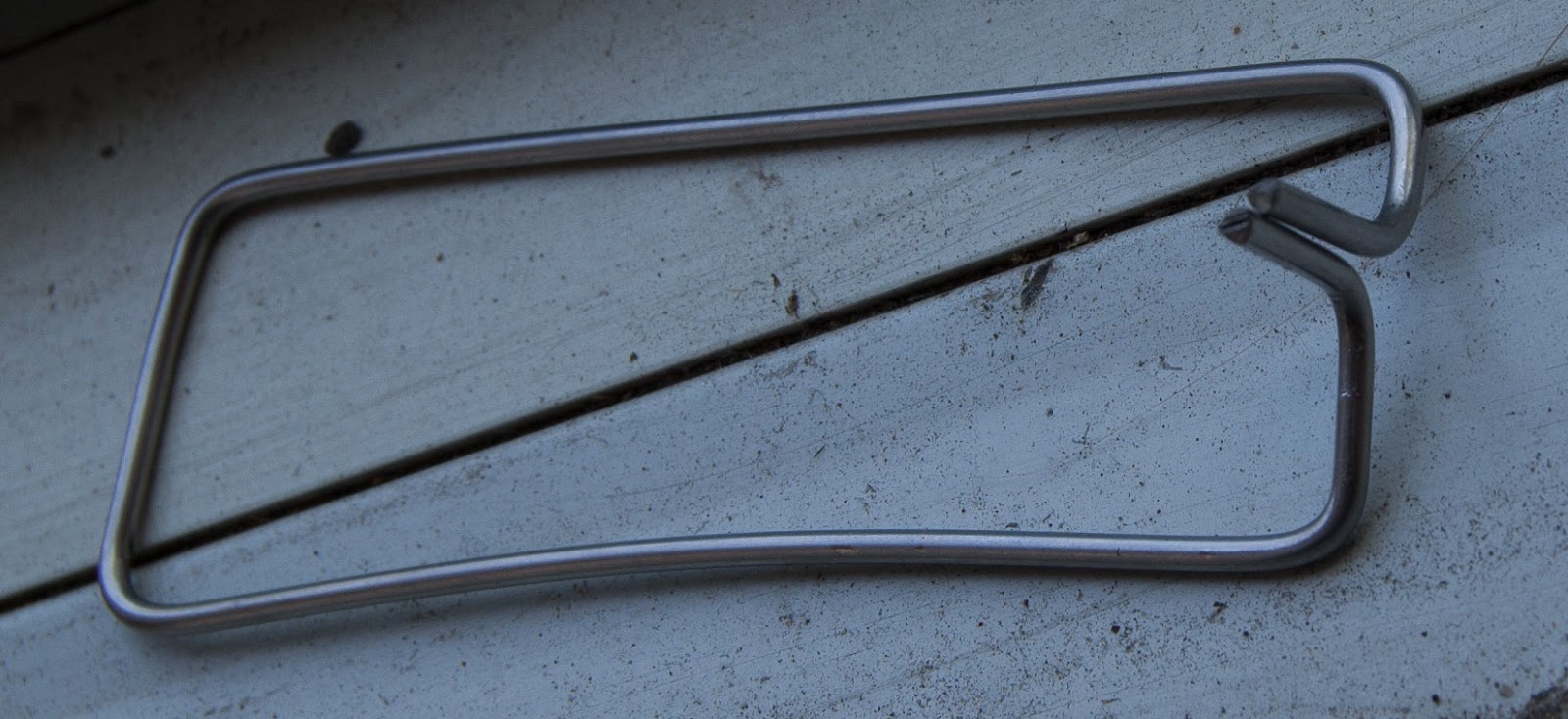

[quote=doncorleoni ]You have to be a little careful measuring with calipers. If the pad contact is not across the full face of the disc you will get a false reading. Some of my discs have worn slightly concave so the thickness in the middle is less than if you measure across the parallel surface if that makes sense.
Micrometer is best for this as you can measure the middle (most worn area of the disc)
Another option is to stick some ball bearings onto the surface of a known diameter and measure across these with calipers if you don't have a micrometer.
I made myself a "tool" by bending an old straight gauge spoke for use with my caliper for measuring thickness of things like that (originally intended for measuring thickness of rims used for braking, which a micrometer won't work for). Don't have a pic of mine, but here's a pic of somebody else's which is much the same as what I have:
Put the end bits either side of what you're measuring and measure across them.
Posted : 07/09/2017 8:48 pm

^ great idea!

Posts: 4726
That's another toy for the mancave, cheers Murray 🙂
