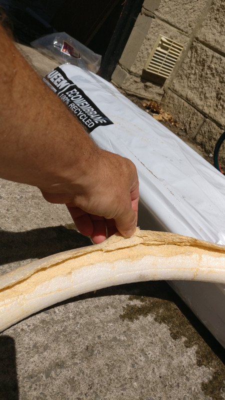

Well, I have just tried to fit the 27.5+ size into a Specialized Butcher 2.8 on a 35mm internal rim. I have given up for the night. There is no air void at all, and when battle resumes in the morning I am going to have to lube everything up with a film of washing up liquid and hope my fingers have recovered. What a way to spend a Friday night...

Round two is a no go. There is no way I am going to get the tyre mounted with the insert inside. I am going to have to trim it.
Should I trim:
The inside circumference?
The outside circumference?
The sides? (I think this is no)
Cut a v shaped groove?
Posted : 15/06/2019 10:18 am

I've found (in my limited experience) that the issue getting tires mounted with these things in is that you really struggle to drop the bead into the rim bed.
I would think shaping the inner circumference to allow the bead to tuck under the insert and into the trough whilst keeping the profile as wide as possible to protect from sidewall pinches would be best. Doing that without a hot wire might be tricky though.
Removing material from the outer might let you chase the insert around a little to drop that bead, but its still going to be tight when you get to your last few inches of bead as the inserts don't really stretch a great deal.
However bearing in mind the early posters feedback on not having an air gap then you will probably want to remove some material off the outer circumference anyway.. so might be worth starting there?

Cheers Jonny. I might try to rig up a hot wire arrangement. What is the worst that could happen?
The Vittoria Airliners have a wee void around the rim bed and a void on the outer circumference.

 K
Posts: 855
I cut one of mine down in to two (inner and outer) with a thin sharp knife. It cuts really easily just go steady to keep on track with a little bit of a sawing action. I was going to use a hot wire cutter with guide jig but got inpatient and thought I need to make a hole to thread the wire so pushed a the knife through.
It has worked really well and given a better feel on the front.
A lot easier to fit the tyre.
Turned the outer one inside out so the flat is on the outside. That one is a bit loose so next time I take the tyre off I'll also shorten it a little and zip tie.
Posted : 20/06/2019 1:52 pm
Posts: 1908
Cutting it down supports other poster's ideas of having more air volume....and also making the tyre easier to fit sounds a bonus - tempted to do that....

I don't use backer rod any more, I use rimpact. Backer rod does work, but I found it not especially resistant to cuts at my preferred pressures.
null
I was swapping out backer rod every 4 months or so and concluded it needed to be denser than I could find it to be a viable longer term, low faff solution.
It was much more cut resistant with a skin of gorilla tape, but it peeled off too readily and became more and more of a faff to implement a system that wasn't any better than some of the cheaper inserts like rimpact.
Still, it was a cheap thing to try at a time when cost effective alternatives weren't available like they are now.
