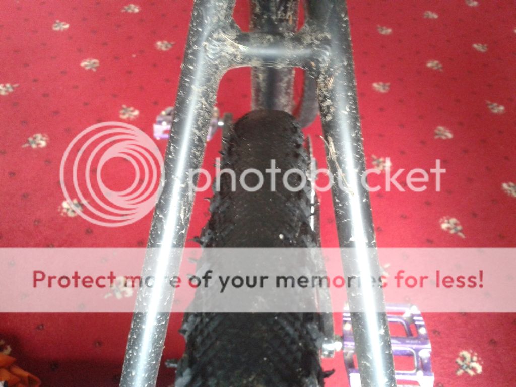

Thats bloody shocking from PX/On One. My frame, although a bit dodgy in the seat tube area has been fine but they bloody well do know about the problem as I had an email conversation with them about it as well as the other up there!!
This was my convo with them 19th June 2015:
From me:
[i]Hi,
I know you have been in discussion with a few customers regarding the London Road Frameset, particularly with regard to the seat tube diameter. I purchased a frameset from you at the beginning of May but once the ‘issue’ was highlighted on the singletrackworld forum (which I think you have been sent links to already!) I checked mine to see if there was any play in the seat tube. Unfortunately I found that there is. Although the seat clamp does hold the seat post in position once tightened.
I am using a ‘Planet X Light Alloy Seat Post 31.6’ & a ‘Planet X Superlight Seatclamp MK2 Titanium 34.9) that I purchased shortly after buying the frame.
I am not asking to return the frame, unless you deem there to be a safety issue, but just want to know where I stand in terms of potential future cracking issues. If the seatpost I am using is too small for the frame or vice versa is the seat tube susceptible to cracking?
I would like to hear your thoughts on this as I do not want to be riding a bike that could have problems but do not want to return the frame for the sake of it.
[/i]
From them:
[i]Hi Adam
Thank you for your email
We are aware of this issue and are currently discussing how to rectify it. However there has been no recall of the frames as our engineers have deemed it not to be of danger to the frame or the rider using it.
Usually the problem is sorted out by tightening the seat clamp and the added area is negligible.
I must stress that this issue in no way compromises the frames integrity. we have had customers telling us of this issue and they have put a 31.8mm seatpost in and its fine. we are looking into supplying the bike with a 31.8mm seatpost as standard but a decision has yet be made.
I hope this sheds some light on the situation.
Kind regards
Robert
[/i]
From me:
[i]Hi,
Thanks for your response. Does this mean you have some 31.8 seat post’s in stock, as I am struggling to find many out there at the moment? I don’t think they are a popular size.[/i]
From them:
[i]Hi Adam
At the moment we don't stock any 31.8 mm seatposts, which i do apologise for though they can be found elsewhere.
Most people haven't felt the need to change seatpost, it's just something that a couple have customers have reported to us
Again my apologies
Robert[/i]
I basically wanted some back up in case it cracked and they started messing about. Like I say though mines been fine, although I did swap the PX post for a thompson.
I'm not sure i'd buy another frame from them now though.

Awesome, thanks for clearing that up guys! Could anyone measure the actual clearance? That would be awesome! I'd order the frame and check for myself but as I live in Sweden just ordering for checking and returning would cost me about 60 pounds. .
Posted : 15/04/2017 11:30 am
 cdoc
Actual gap between fork legs is 50mm, same at the seat and chainstays.

 cdoc
[img] ?t=1492175684[/img]
And the back. Have had a 42 on it with lots of mud room to spare, but was too bouncy for my liking. 35 feels nice.
Edit: Nah, I think a 50 might just be ok, tyre profile dependent.

Awesome cdoc, thanks! Looks like I'll be ordering the frame then 🙂 I've got loads of weird ideas for this one. . if i can i will put 29'ers in it. If not, i'll get another fork and might go 29 up front 28 in back. sure there will be plenty of people that will hate it but . . 😛 my idea is to make a fast commuter that feels playful like an urban mtb. If anyone wants to follow, i can upload pics of the project as i go along?

Ideal for 40c Nanos. Or wider slicks, but Nanos great fit with plenty mud clearance.
A 1.95 Renegade will Not fit. No way, for reference.
