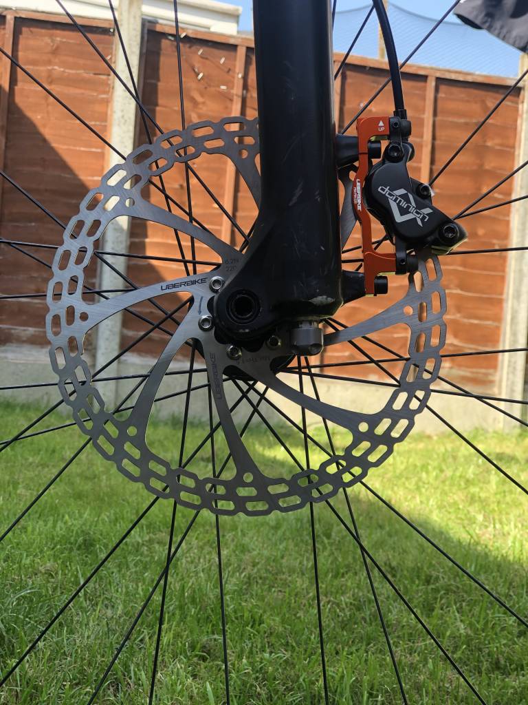

Finally got around to fitting mine after the front Guide failed on a ride. Again.
IMG_6188
IMG_6189
Uberbike 2.0mm 220mm rotors and spacers with the Dominion calipers. I did the front on Saturday as it's easy and the improvement over the Guides is phenomenal. The rear was more of a challenge and I had to drop the motor in the end to get the hose fed through the frame. I've used the bar clamps that came with my and my buddy's AXS conversions for the shifter and dropper lever. I was looking to get some Peacemaker clamps until I saw the price!
