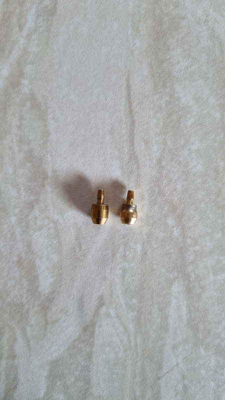

As above, the Olives I purchased don't fit... or I just don't know what I'm doing. The latter is perfectly possible - I've never setup hydraulic brakes before.
I purchased:
ELVEDES ELV-HY02 OLIVES with INSERTS for HAYES
ELVEDES ELV-HY01 COMPRESSION Bolts for HAYES
From eBay seller, Pukker Bikes
The Olives don't seem to fit. I *think* the shoulder of the olive is supposed to go over a few mm of the hose? It doesn't. It seems that the hole in the bottom of the olive is not wide enough. As a result, the "mating" between the olive and the hose is not secure and can be pulled out with very little force. This is the same when the hose is inserted into the lever and the compression bolt is tightened - the hose just pulls out / or leaks brake fluid (as I unfortunately discovered).
I'm intrigued if I'm at fault here or the parts are?

@bobolous is the first pic before or after tightening the crush nut?

That brass fitting isn't right.

It doesn't look like the ones I bought off ebay. Looks like its been used already

Posts: 2124
So had a weird one today. Had a hose detach itself from the brake lever when I got the bike out the van. Thought user error when fitting the barbs into the hose. Gave the other hose a tug and that detached as well. Got home and took them apart and fitted 2 new barb / olives. These also didn't grip into the hose and could be totally removed by hand. I expect the olives I bought from ebay are too thin to grip into the hoses.
So next step. Get in touch with hayes and try to get proper olives etc?? Or is there a supply in the UK. I can bang my old brakes back on but I really liked these.
Posted : 21/05/2023 1:30 pm
Posts: 3149
Did you do the nut up enough to deform the olive?
Posted : 21/05/2023 2:49 pm
Posts: 2124
Ye I'm pretty positive. But the even if not the barb seems too thin. Can be inserted and pulled out pretty easily by hand.
Posted : 21/05/2023 2:54 pm
dc1988 reacted
Posts: 7915
If the olives were adequately compressed it would have gripped the hose so hard pulling it out by hand would be pretty hard/impossible.
So the question is - are they undersized?
Got any pictures of the used/unused parts?
Posted : 22/05/2023 10:01 am
Posts: 2124
Ill post up some later when i can. I'm hoping it was user error and i am just being a nugget :0
Posted : 22/05/2023 1:02 pm
Posts: 2124
Hopefully this image works OK. Both the olives were crushed but obviously not enough to grip the hose properly. Good chance I didn't to them up properly. Never had this issue with brakes before and I have fitted loads.
Olives
Posted : 23/05/2023 9:35 am

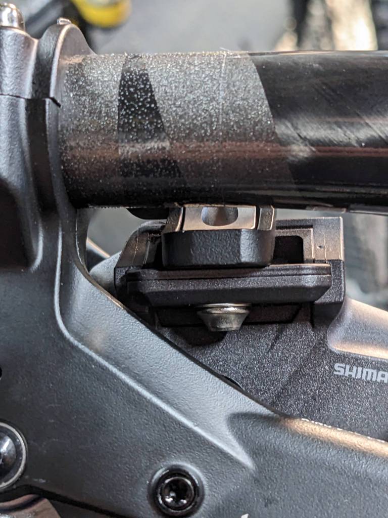

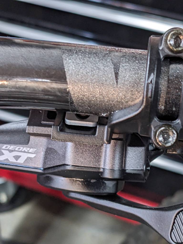

Is anyone using one of the Peacemaker clamps with I-Spec EV shifters? Do the clamps work well?
I believe they were initially only compatible with earlier I-Spec I/II shifters, so I'm interested in how well they work with the EV spec stuff.
Posted : 12/09/2023 3:39 pm
I effectively had the same problem as @mactheknife. The generic olives I purchased on eBay didn't fit properly. I noticed the issue due to one of the brakes leaking. When I gave the other a fairly gentle tug, it completely detached too.
I concluded the issue was with the Olives, which are not the same dimensions as the official parts from Hayes.
I reached out to Hayes support, highlighting that there were no UK based retailers where you could purchase the official Olives. They kindly sent me a couple of service kits.
  • Insert and Olive 2-Pack: part no. 98-39471
  • Brake hose with banjo kit:  part no. 98-36138-K001
If you search on these part numbers, you can find a few European sellers, and Mech Monkey in UK seem to have them in stock 🙌
Posted : 12/09/2023 3:47 pm
Posts: 8652
I just got one attached to a bike I bought. Appears to work very well with the I-Spec EV shifter, shame they don’t make one for the left to fit my dropper lever to. I know it has a fair bit of left/right adjustment but can’t remember if/how much rotational adjustment there was. How you get on with one will depend on where you like your shifter in relation to the brakes though.
I have just bought a Formula clamp (which I am hoping will fit the Hayes brakes) for my dropper lever, may fit it this evening. I like the tidyness of everything on one clamp, I wasn’t actually having a clash with separate clamps.
Posted : 12/09/2023 4:04 pm
