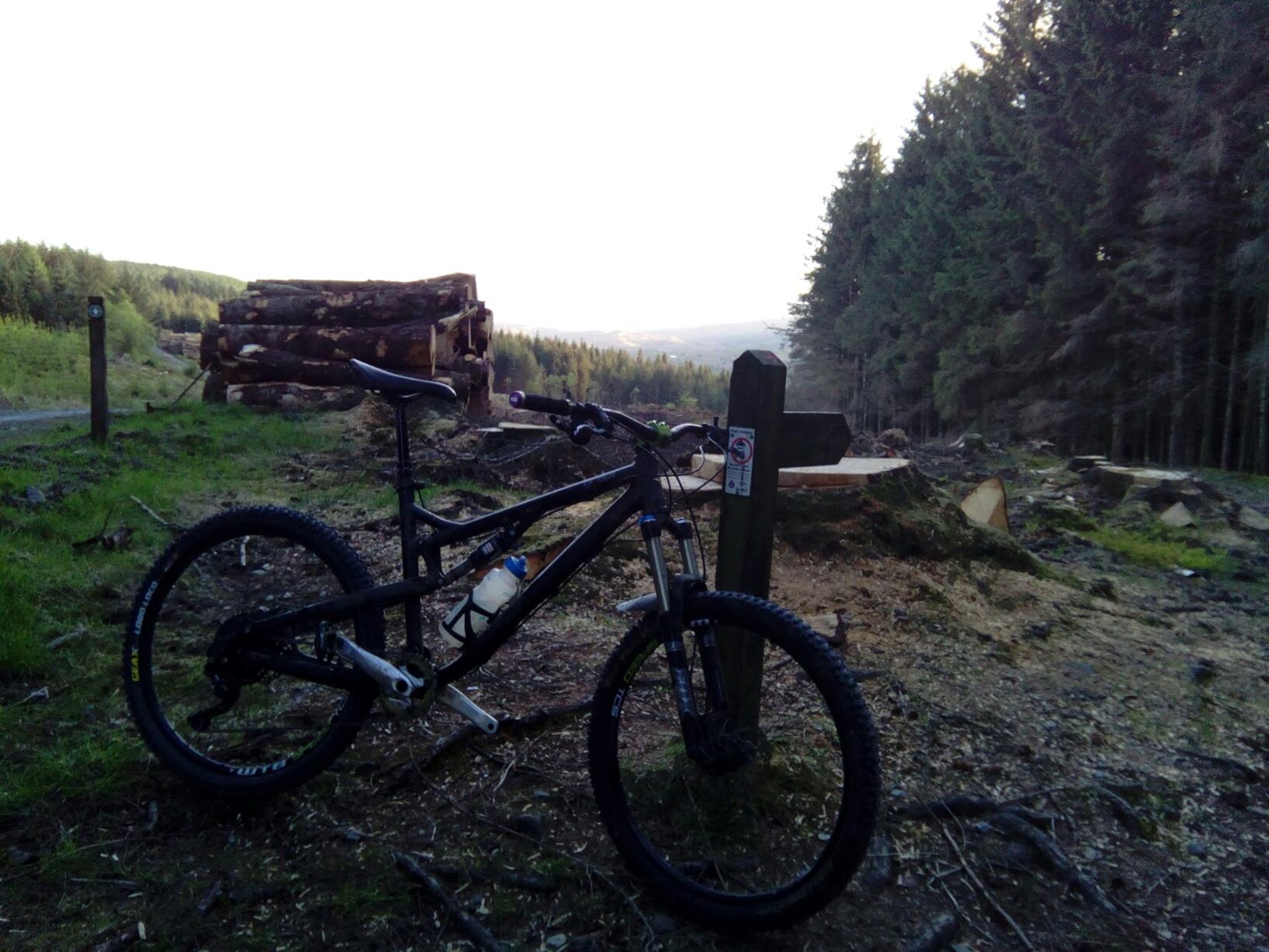

Go on then: changes since last time, new/old saddle, reverb, 10*11-42 cassette, 34 tooth chain ring, 800mm bars, xt mech, zee shifter, tyres.......
Photo at the top of the lawson park descent, Grizedale which this thing loves, flat out drops and flat corners, BRAAARRRP!
Posted : 06/06/2016 9:43 pm

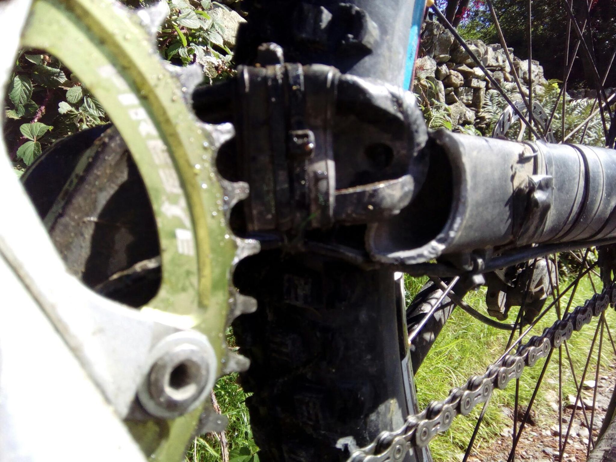

Wahey!!! I'm in the Snappy Grapil Club!!!
Still got a bit of this in before it went at the bottom of Garburn (before having to push back round to Dubbs)
