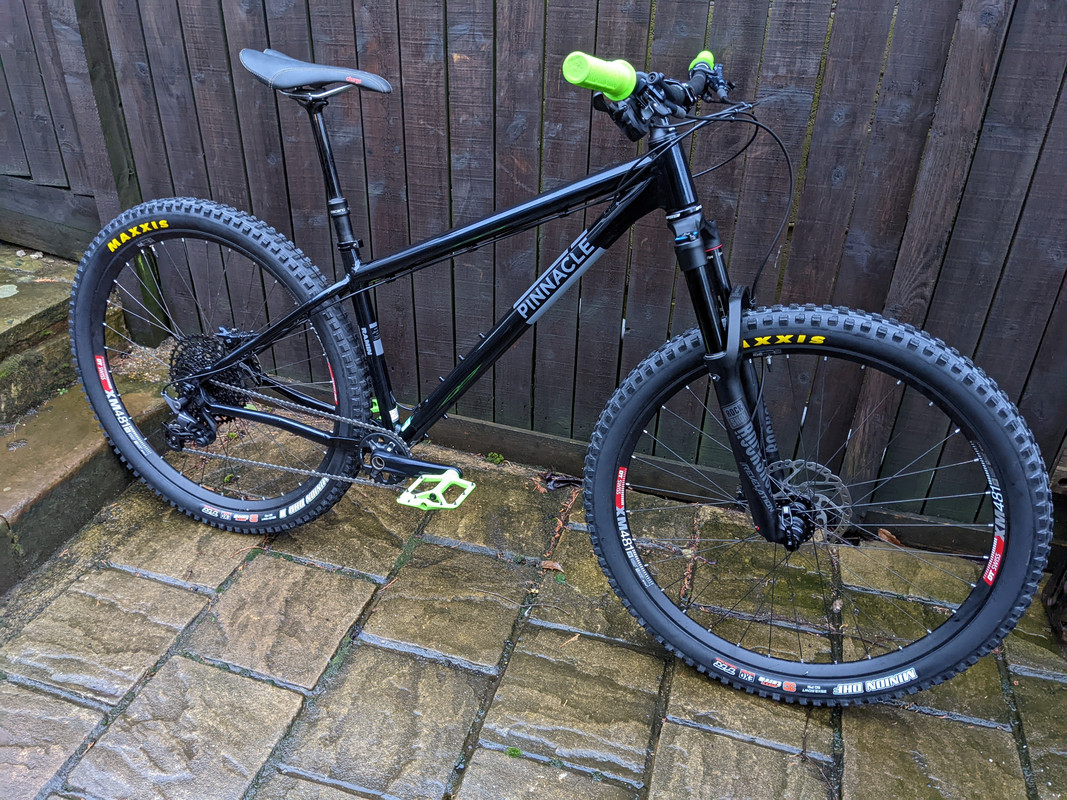

Mine just arrived. Pleasantly surprised, the frame is nice and light, the lime yellow is awesome, good UK things like the seatpost split is at the front, and it came with a headset. Pleased with this.

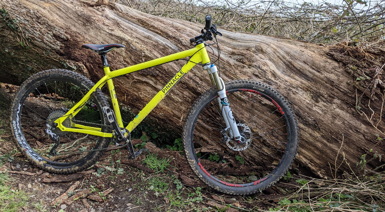

Here's a 29er x 2.4 tyre in me frame. Not the widest rims (old Stans Flow), but enough clearance.

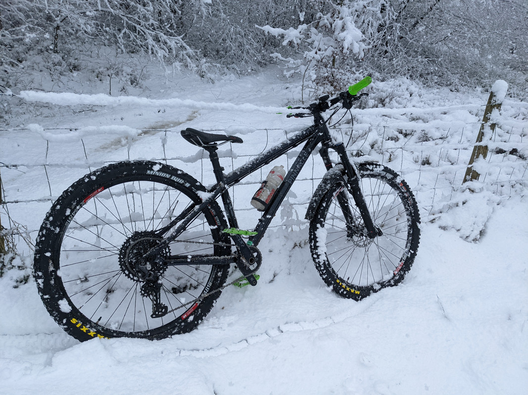

I've finished building my Ramin, had a little ride on it yesterday, conditions were too snowy to get a proper feel for it!
Ramin
Snow
Posted : 20/02/2022 10:24 pm

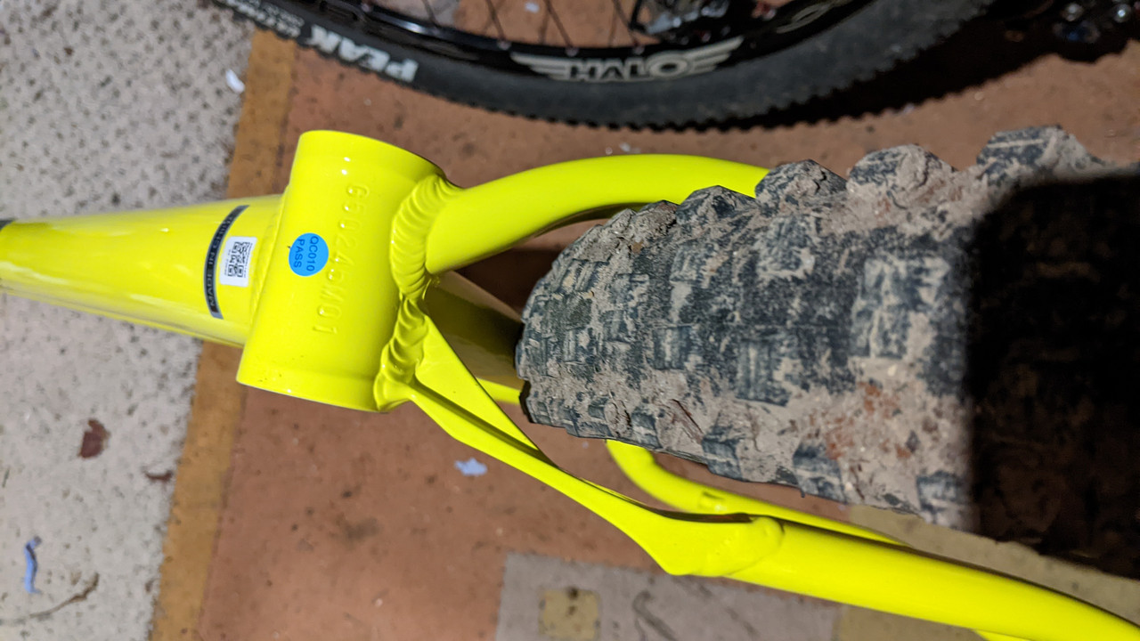

Ahahaaaa. Yes, I ordered the frame and the seat tube clearance was terrible so I sent it back. Evans was unhelpful with the frame specific fittings too. Cost be 20 quid in.postage 😞

Correct ^ It's a 650B frame, you won't get a 29 tyre in there. Gravel / 700C commuter tyre maybe.
Posted : 22/02/2022 8:47 am
Posts: 3252
Had the bike upside down and didn’t notice how close my tyre was to the seat tube. ie. very

how close is close?
I recall my first fisher 29er was pretty tight to the seat tube, maybe 4-5mm clearance with a 2.25, but it was designed for 2.1
Posted : 22/02/2022 10:13 am
Posts: 6458
My tyre was the one in the background of my photo, a Goodyear Peak 2.3, which is pretty-much a semi-slick and was probably 3mm from the seat tube. So you [i]would[/i] get one in there, but choice is limited.
Posted : 22/02/2022 4:14 pm

Posts: 226
Thanks for all the advice above.
I've gone with a mullet build in the end, 27.5 (2.6) on the back and 29 (2.35) on the front with a 120mm 29 fork, seems to be pretty well balanced and doesn't look obvious. Build has come in at 13kg, Size M fits my 170cm 12yr old perfectly with hopefully a bit of space to grow, she's well happy with it.
My pal who's a very good rider and the right size (I'm a bit big at 6'3") had a razz on it yesterday and was vey impressed and didn't think the geometry was compromised as a mullet for climbing.
Iroko Mullet
edit: bah, cant get image to work but hears the direct link:
https://www.flickr.com/photos/191420910@N06/shares/A47M80
Posted : 14/03/2022 11:03 am

Posts: 6458
Similar to mine. Odd wheels, old Fox 32s (mine are white). I bought some of those £30 cranks from Ebay. I've ridden it twice then injured myself, but it felt pretty good.

Posts: 9164
Looks great that..
A 120mm 29er is a good swap for a 140mm 650B front end. Forks pretty much the same length. You get a good amount more trail / stability from the larger f wheel but the angles don't slacken + BB doesn't raise as much as if you got that same trail increase by keeping the 650 f wheel and adding a longer fork only. Maybe I missed them on here but I'm suprised there don't seem to be more mulleted 650B HTs around.
