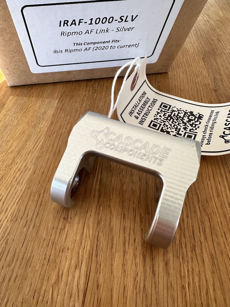

My cascade link arrived today. It’s very shiny.
I will get it fitted this afternoon and try and get out for a ride after work tomorrow
Posted : 14/02/2023 2:07 pm
