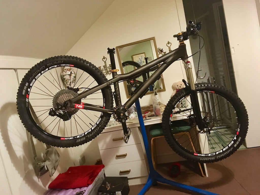

just building a new 24 HT for my son.  looked at the current range of FS bike and decided they were too expensive and heavy for his current abilities.  I wouldn't bother with one of the large travel bikes unless he is actually going to make use of it.  Liked the look of the trek jr or the norco fluid.  The ripcord is got decent geo too.  What ever bike you get the fork/shock will need tuned.
Still got a few bits to fit but will be ready for xmas.
