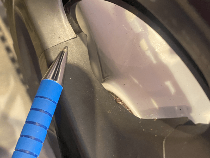

Thoughts on my diagnosis? This is on a 2019 Giant TCR.

Anyway, I've spent the last few weeks in and out of the LBS chasing a mystery creak that we simply could not solve (there's actually another thread about this somewhere). Changed BB, greased everything you could possibly grease and still it persisted. The creak is from BB area and only when under load, every pedal revolution, it sounded to me like the drive side crank though the LBS thought it was both.

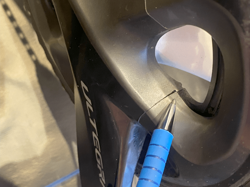

I checked my crankset model number this morning and sure enough it falls under scope of the recall. I've also had a look at the drive-side chainset and reckon I can actually see where it's started to delaminate where the two pieces are bonded...I've included a photo of what looks to me like a good bond and the suspect one. Does it look dodgy or just a normal defect? In light of the recall and my mystery creak I guess it has to be assumed defect, right?

Is that gap not just where the outer chainring butts up against the chainset?
Have you checked the chainring bolts? Removed, regreased and retorqued them?

Yeah bolts have been checked at the shop. I think the first pic is a normal/good join but the second one is where its starting to come apart? I'd expect to see a seam but not a gap if that makes sense?
I think there's 4 joins and 3 of them are flush as per the first pic but one has a gap. If it wasn't for the product recall I'd have assumed its a tiny manufacturing defect but in light of the recall and the knowledge that my cranks fall under the affected products it seems more likely to be an issue?

I wouldn’t ride that another mile. I’ve had two 6800 cranks fail on me and will be taking the one I have left in the garage in to get checked/replaced next week.
The first one felt as if the crank was very bent and when I inspected it there were quite significant gaps and signs of the bonding having failed - I was really annoyed and angrily threw it in the bin. The second one started creaking a while later and when I checked there was a small gap just like the picture above (maybe slightly wider)- this is the one I’m hoping to get replaced…
I replaced both with later model R8000 cranksets (both luckily with serial numbers outside the failure window) and they have been fine, although I will be keeping a very close eye on them as I am a bit of a sprinter and give those cranks a bit of a hard time.

Ah I see. Yeah on closer inspection the second picture you posted shows a noticably larger gap. I've not seen one fail first hand, but I'd try and get yours looked at if I were you.
