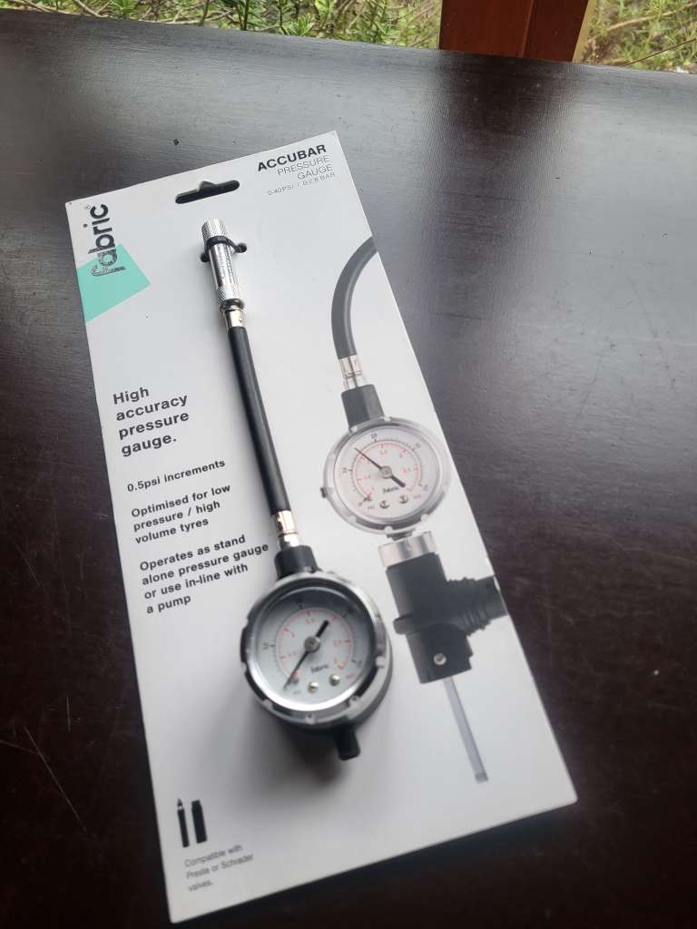

I use a fabric pressure guage on mine. I've 3 for sale in the classifieds

20240105_132612

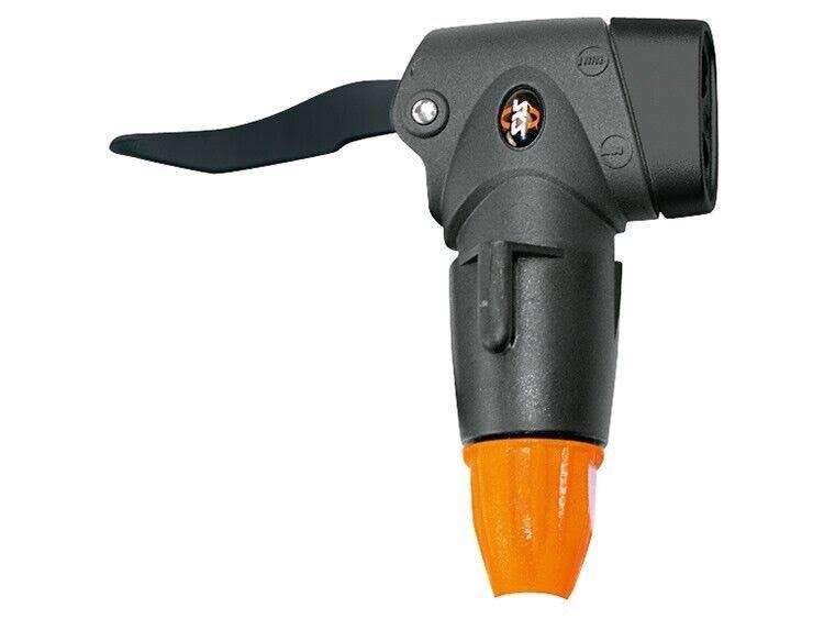

This. I got a cheap one from Screwfix, cut the original head off and attached an SKS head.
Plug and play, as they say.

I’m using a pump head from Decathlon on mine and no leaks. Just cut the old crappy standard fitting off. <br /><br />

I have that SKS head and it's crap for seating tyres as when you take the presta value core out it constantly switches to schrader mode.

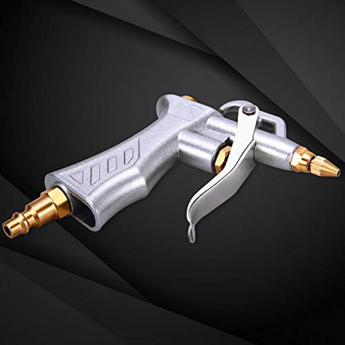

The simple blower head for the compressor is best for seating tyres once you have the valve core out

I assume you're only looking for one to facilitate beading a tubeless tire?
If so, like Nick above, a blow gun is the best thing. Remove the valve core and trigger the largely unrestricted air in through the valve.
I use a mega cheap plastic one with the metal end snapped off and it's brilliant. The snapped off metal end is the same diameter as the end of a presta valve stem so fits perfectly.
You don't even loose much pressure in the time it takes to put the core back in if you use your thumb as a temporary plug then go back to the pressure you want with a track pump.
Similar to this
