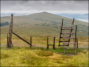

In the Ochils there are some massive amounts deer fences with ladder stiles. One is tricky, two in a row are unpleasant. Three is the absolute limit. 2018 Levo for context.

It’s fine lifting it over a stile. Unless you have a health problem then being able to lift an ebike over a gate or stile is probably a decent minumum benchmark for upper body and core strength.
I'm sure gates would be fine, but stiles are pretty risky as you need to climb up high, turn around, climb back down. One hand for the bike, the other to hold on to the stile.

This is the kind of stile that wears me out.

You can lift a half-fat eMTB over a gate, but I wouldn’t fancy carrying one over a stile (especially a deer one).
If you can't lift a 25kg ebike over a gate or stile, then you really are a dweeb. Do you even lift bro?

Gate would be fine. See the deer fence stile TroutWrestler posted. It'll be 1.8m high, steps aren't flat and don't have grippy metal on so could be slippery, no platform at the top. And it's on easy ground. Strength is probably ok, but navigating the bike through with only one hand is tricky, height doesn't make it hugely more difficult but increases consequences of failure.

If you can’t lift a 25kg ebike over a gate or stile, then you really are a dweeb. Do you even lift bro?
I don’t mind admitting that I can’t lift my RM Altitude over a 1.60 metre high gate - not and actually lower it down the other side too.
I’m officially a dweeb then, it seems.....
