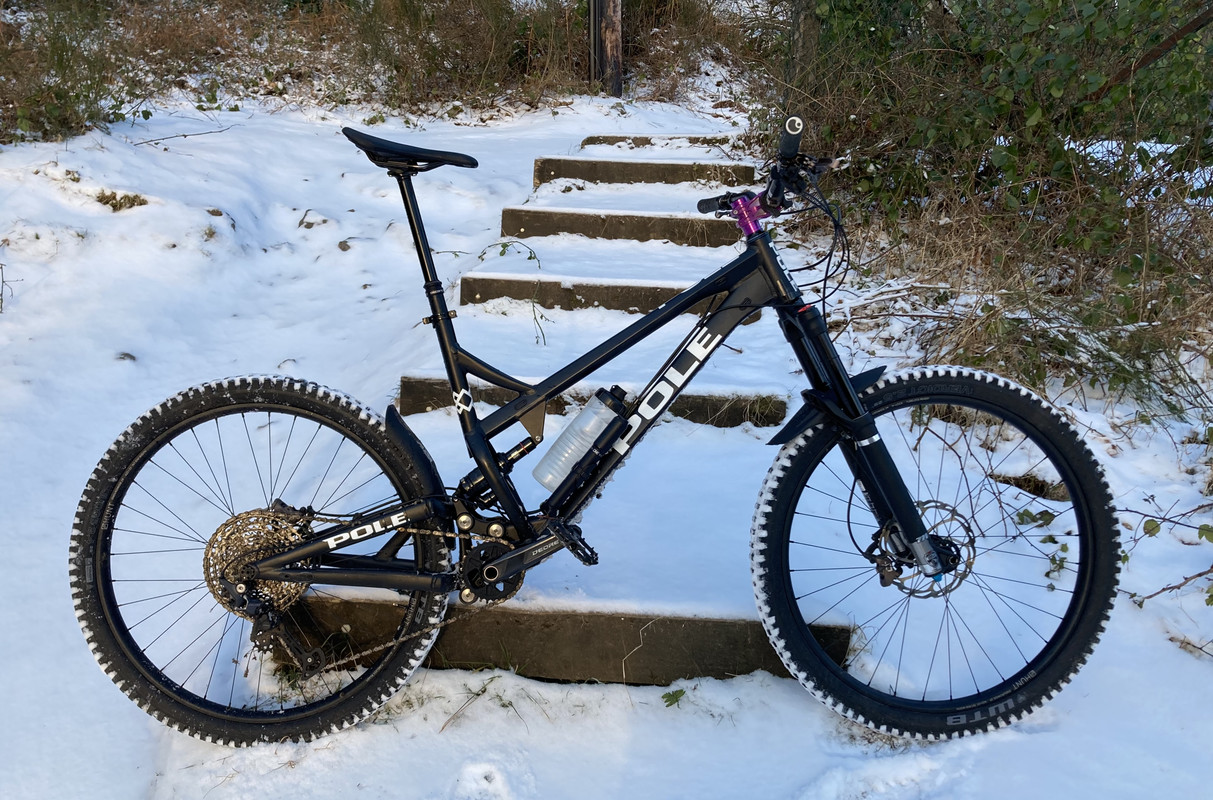

TL:DR - by eck, those Pole fellas (hi Leo!) have got it sussed. XL 140 evolink is LUSH.
BRAAAAAP! on anything techy and downhill.
WHOOSH! pedals along and uphill beautifully with no bob, but a lovely active suspension (really remarkable) that negates the inertia sapping rocks and bumps and doesn't get hung up.
Perhaps most interestingly Barney also was quite right in his review of the 158 a few issues ago: just tip it into tight corners/switchbacks, downhill or up, and it just whips around. I don't understand that feature, I really don't. But he was right - just tip it in, let off the brakes or give a wee accelerate, and... whhiiip! it's around. So much fun. I've ridden plenty of bikes, and this feature is just uncanny.
In general, it absolutely smokes any full sus I've had before (2007 stumpy, Ventana El Capitan, NP mega (x2), 2015 stumpy Evo, Tallboy (briefly)), suspension tune is perfect for a 115kg guy, and it fits!
As you may have seen, I've been wanting a bike with 'normal' components recently rather than current somewhat unreliable 29+/full fat on 150/197 hubs, but the right geo - considered an emergency Hello Dave (but decided another HT was a bit daft), bird AM9 (stack a bit too low, SA a bit slack and it just didn't talk to me which is sad as Bird are lovely to deal with), Cotic Rocketmax (told me it was a no go for my weight), or Geometron (sooo close, but they are just too expensive).
Pole were also actually really good to deal with - shipping got stuck a bit due to Christmas and Brexit, but they communicated well and immediately, everything arrived perfectly, and they seem to be getting their CS act together in a major way. 🤞
Sold my gravel bike (sorry, too boring), sold 2 other unused bikes in the shed (too small for son, girls not interested in Gnar), sold some old camera kit, made the purchase.
Other wee notes: Deore 12spd is bloody lovely, a complete bargain, and feels better than my XT 11spd; Verdict and Judge tires are ridiculously good; brand X dropper 200 is not as nice as One Up 210 in action. Hunt wheels seem good - fast pickup. Mezzers are very nice, hope they hold together!

Glad to hear your story had a happy ending.
Regarding the magic cornering, does it have longer chainstays than you are used to? I've found that can help bikes corner with less effort.

@chakaping - I don't think they are longer, maybe a wee bit.

Purple head. long, stiff, black Pole. nothing to see here. Its pronounced Poh-Lay in Finland apparently.

Any chance of a sideways pic?

If we are putting in photo requests, could we have a sideways photo with the seat up at normal pedaling height and down?

Will do sideways pics, saddle up and down - I will state for the record that it's not got the most... flattering profile. Like me! ugly but functional.
My Saddle height is 850mm from centre of BB axle to top of the saddle BTW, in case thats important to anyone.

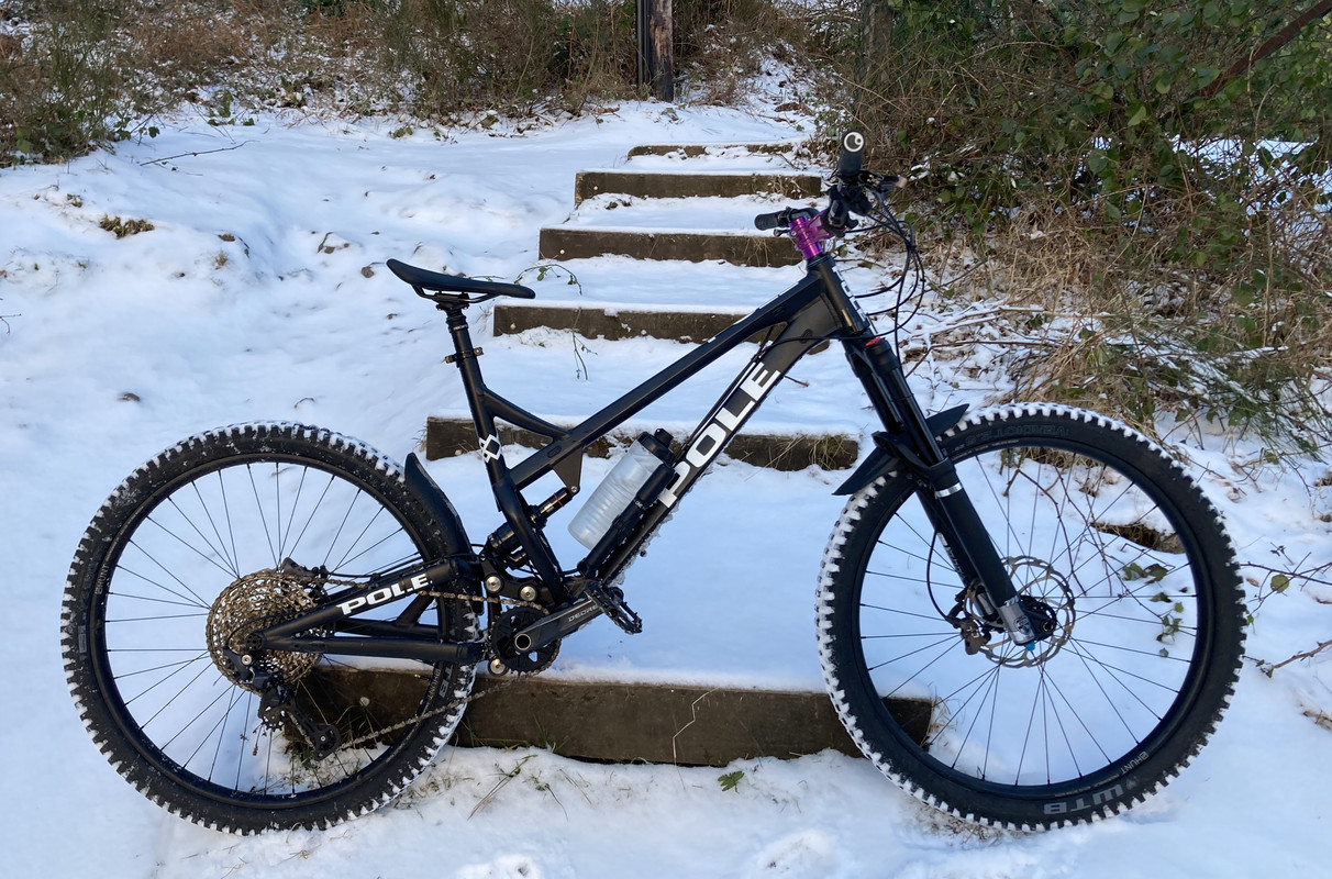

For those that requested, @jkomo & @tall_martin are these OK? Bars at a bit of a funny angle which might not help, but should give you an idea.
Sorry, no idea on weight, don't have scales. I would say: heavy.
Final shot just for bike porn purposes.

Thanks!
It's always good to see what other xl bikes really look like. Especially the ones with the steep seat tube angles.

@tall_martin - I think the seat angle could be steeper. It's 78, but once sagged, esp going uphill, I think it might be more like 76/77 which is not so dramatic now (but still it feels just steep enough).

FWIW, this feels bang on. its 535mm reach FFS, there ain't much longer!

@tall_martin – I think the seat angle could be steeper. It’s 78, but once sagged, esp going uphill, I think it might be more like 76/77 which is not so dramatic now (but still it feels just steep enough).
Don't they get steeper when sagged? Fork and shock compressing are both rotating you forward slightly
Posted : 09/02/2021 2:34 pm
Posts: 13942
"Don’t they get steeper when sagged? Fork and shock compressing are both rotating you forward slightly"
Shock compresses more than fork because we run equal or more sag on the shock vs the fork, and the shock sag happens vertically but the fork sag on the diagonal (~9mm vertical for 10mm of fork travel). And then once you're putting uphill there's more weight on the shock than the fork so the fork sags less and the shock sags more.
It's hardtails that get steeper (by a lot) under sag. Full-sus bikes get slacker unless you're running much more fork travel than rear travel and running the fork notably soft.
