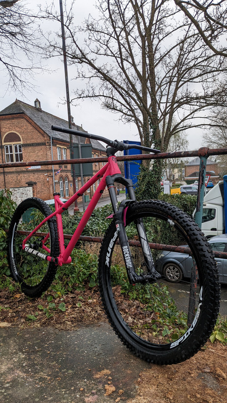

I have new forks on the hardtail and suddenly my previous brake set up that I'm transferring over from older forks doesn't line up so well and I'm clearly missing something obvious.
I have a 203 rotor.

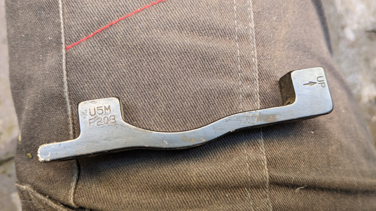

I have a 'U5M F203' adaptor.
Forks are Revs, maybe couple of years old.
Previous forks were older Revs.

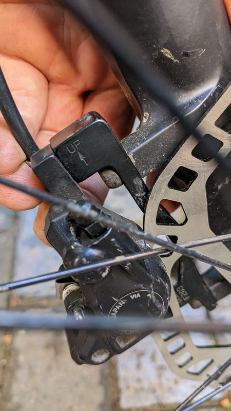

If I mount the adaptor with the 'UP' marking uppermost, the caliper fits but barely covers the rotor at all. Maybe just about 5mm of the edge of it.
If I mount the adaptor with the 'UP' mark down, the caliper goes on too far and the caliper body, grounds out on the rotor.

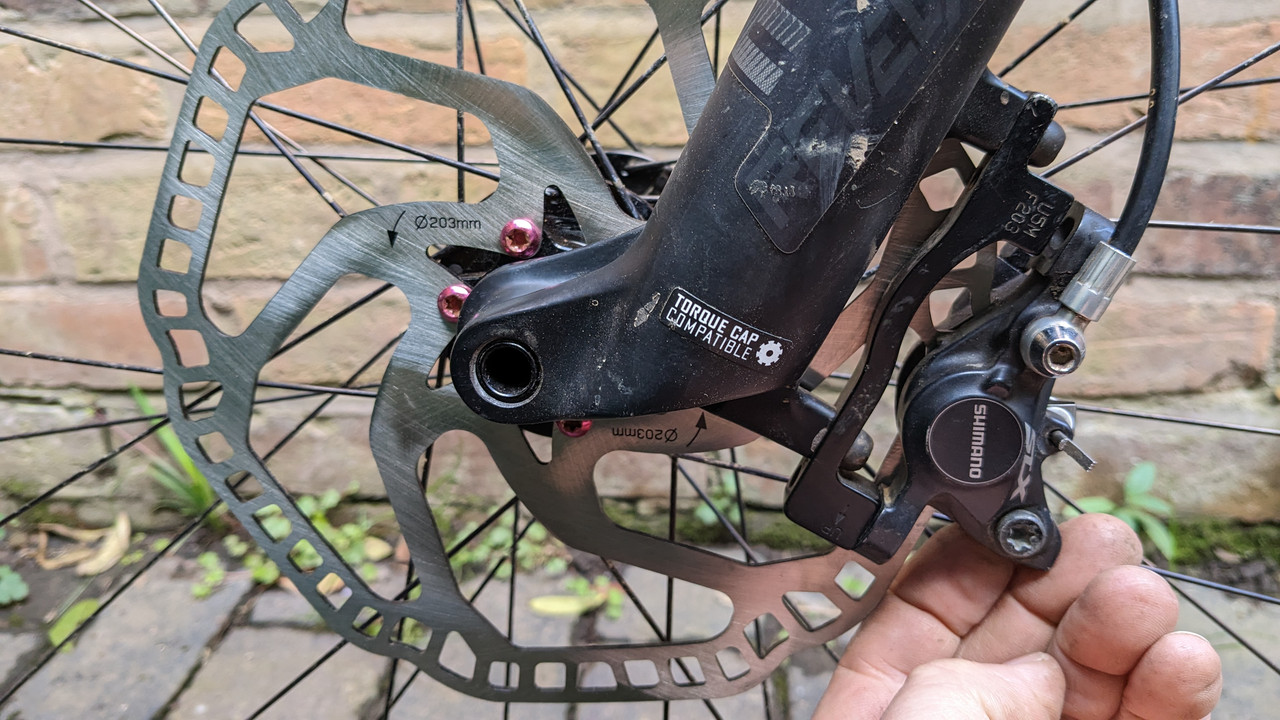

Has the actual post mount on forks changed without anyone telling me, or worse, am I missing something blatantly obvious?

We're your previous forks standard 160 without adapters and your new fork is 180 standard without adapter?
You might need a smaller adapter as your starting 20mm further out than before?
Try a 180 adapter for the 203 rotor and see what it looks like.
Quick Google and minimum size is 180

As above, 180vs160 post mount lowers

I'm fairly sure every current fork is 180 post mount as standard now, the revelations went from using the old 32mm stanchions to using the same 35mm stanchions as pikes.

You will probably find that a 160-180 adaptor commonly used on the rear will do the job perfectly well if you have one of those knocking about
