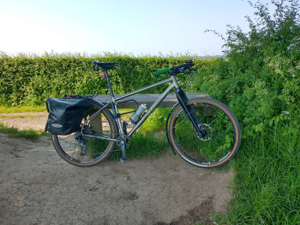

I bought a set of vaude panniers in 1997. I've commuted for 15 years since then. They are still waterproof. Bit battered, but the reflective and three bits of gaffa tape to reinforce some of the wear areas.
The second hand bike I bought in 1997 had an old man mountain rack. That's still in use as well. Currently I've got a Topeak rack on. That came on another second hand bike. It does its job with no fuss.
IMG_20230609_164909716_HDR
So that's my recommendations.
I'd be messaging therevokid.

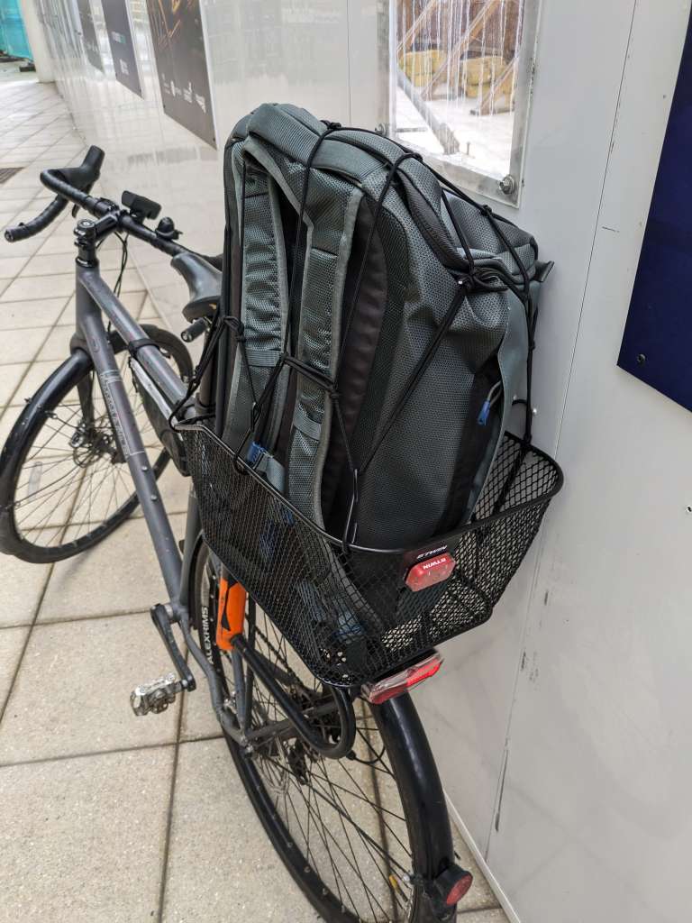

  • Recommend giving a basket a chance - I use one and it's great - use any bag you want and doesn't stick out the side of the bike etcPXL_20240410_162305860.MP
