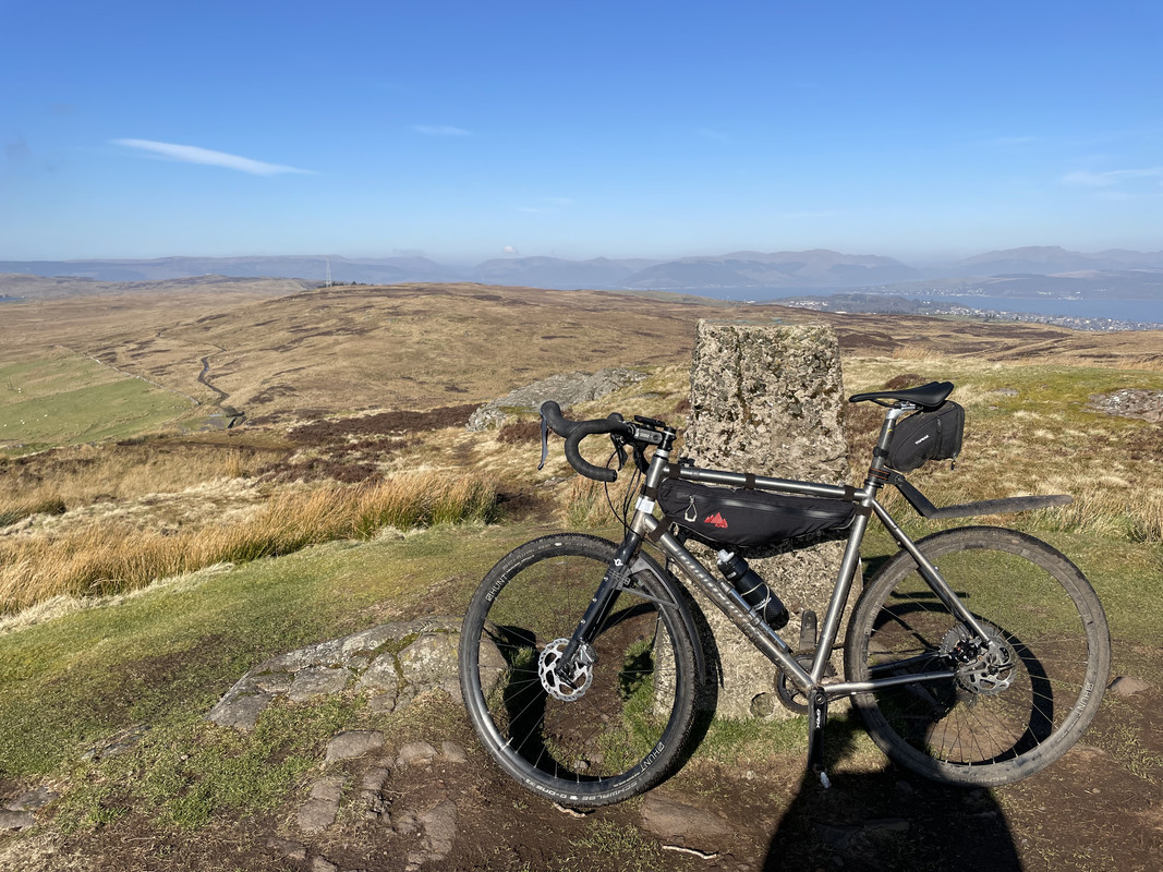

Posts: 43521
On an old van nic Amazon tourer (that has magically morphed into an on trend gravel bike).
Aye. Funny how that happens...
[url= https://i.postimg.cc/mD7nMNh2/DSC-2711.jp g" target="_blank">https://i.postimg.cc/mD7nMNh2/DSC-2711.jp g"/> [/img][/url]
Posted : 21/03/2022 9:19 pm

Posts: 652
I had a frame like yours but got an updated one when the chainstay cracked a few years back…
