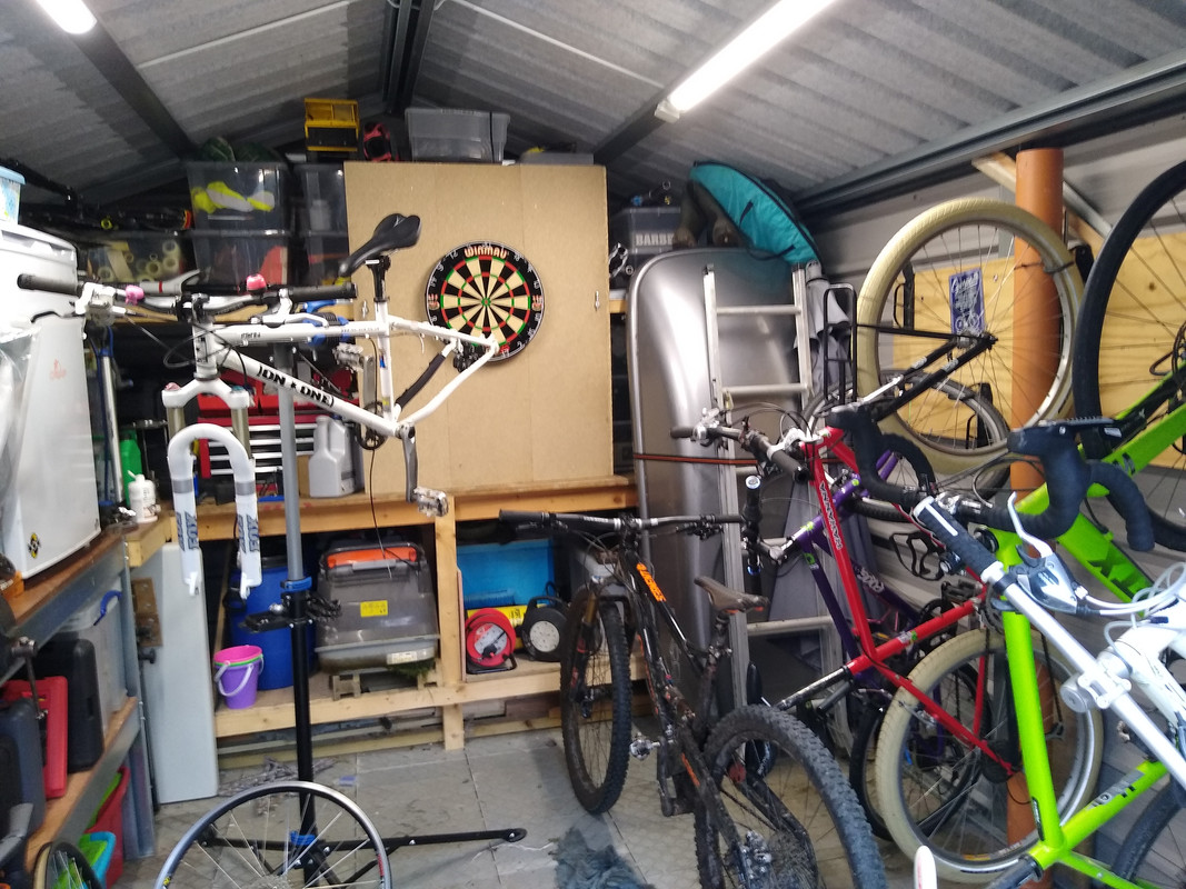

Posts: 8845
I've got two wall brackets on a shed about 6-7ft wide, Square section steel between them, about half inch square and another similar vertically in the middle down to he floor for support. I hang them by the saddles with front wheels off.
I can fit seven bikes on it, but if I want one from against the wall I have to remove either three or four bikes to get it out.
Sounds like your idea but less fancy.
